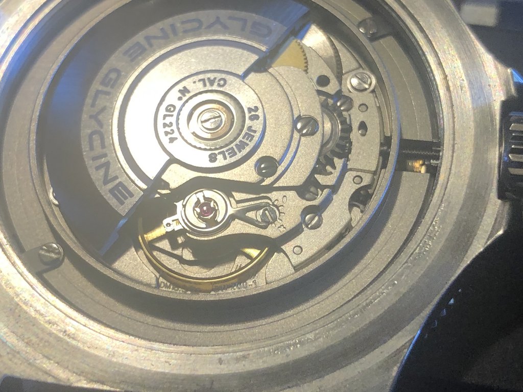

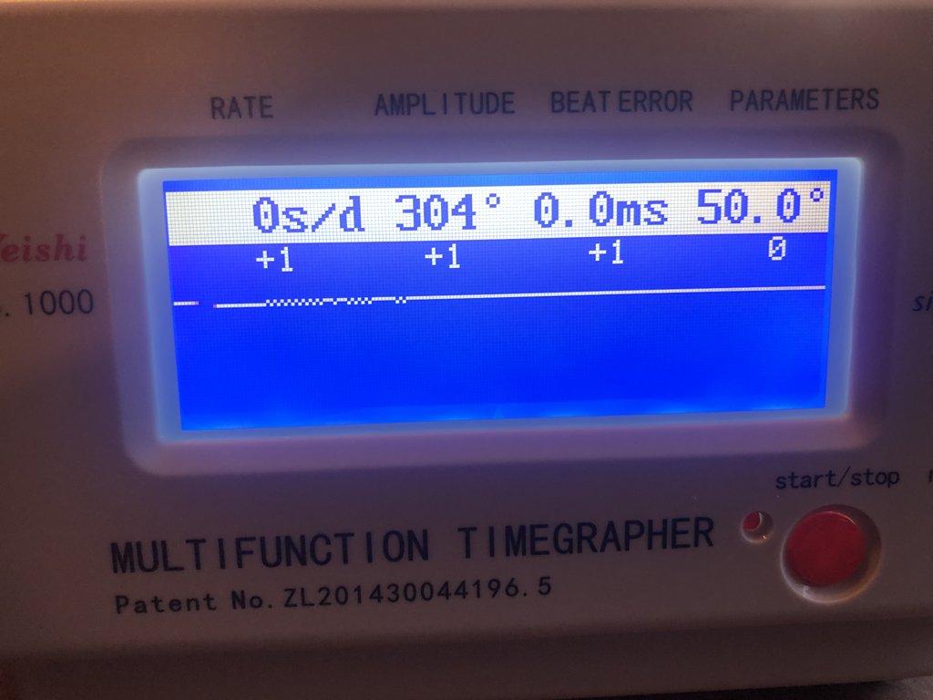

Success.
I'll see how it does over the next week. Display caseback and lumed sapphire bezel insert by the end of the week.
Now, the downside is, I was feeling so good about this, that I tried to do my Invicta next. The adjustments were really difficult to move, and with my first small adjustment, the movement stopped. I adjusted both the beat error and the rate and got it moving again, but it's horrendously off. Like, 8ms beat error and +900 seconds a day. Going lower shuts the movement off. I watched a video of a guy doing it and all he had to do was gently nudge the adjustments and I had to carefully bear down on them. Seems Invicta over-cranked the shit out of something, possibly when they added their signed rotor. Not sure what I want to do with it yet, but I'm tempted to buy a whole new movement, dial, and handset and start fresh. Probably before that, I'll pull the movement apart to its last piece just to explore and learn. Maybe in the process of doing that, I'll manage to loosen up whatever's holding the adjustments so tight and I can get it running correctly.
Congratulations on regulating the Glycine!
I missed this, somehow. Thanks! It wasn’t as bad as I imagined, and in practical use, I seem to be losing a little over a second a day, so I’m going to go back in a bit later this week once I’m sure it’s settled and see if I can get it to +1. If you’re on the fence about a timegrapher and you can afford one, I already see a lot of value in having one.
