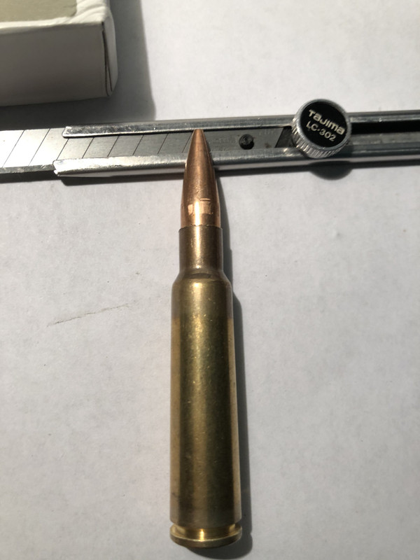

Here are some pictures for clarification:
Reload round on left, GP11 on right (both have same cartridge overall length)

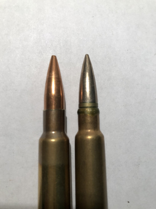

Bullet ogive comparison, reload on left, GP11 on right
Reload striking chamber throat
Non-verified seating depth for Hornady 168gr HPBT (seems quite deep to me)

Hornady seems to design their bullets with full diameter carried farther forward than some other brands, then a sharper nose angle. I have had your problem with several calibers. Try the same OAL using Sierra, or Nosler bullets, I think that will fix the problem.
Posts: 1665 | Location: North Carolina | Registered: June 16, 2004Reply With QuoteReport This Post
Picture of sourdough44
Yes, that bullet on the left reaches full size closer to the tip, obviously.
That’s the reason it’s fairly common practice to measure to stay a tad off the lands.
