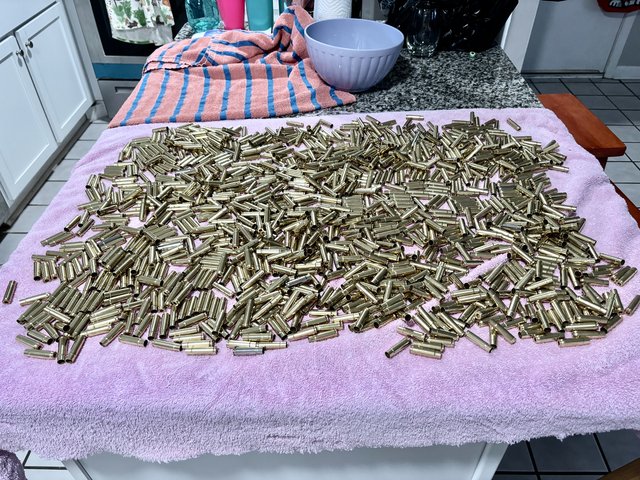

Less is more. Barely a teaspoon lemishine. Drop of dish soap. If water 30 minutes it need a bit more I drain the dirty water mostly, add another drop of dawn and fresh hot water. Haven’t had to go more than 90 minutes but that was NASTY 308 once-fired.
Here are 1100 300 BLK ready for trimming, reaming, then reloading.
Gonna be 500 135 gr. And 500 220 grain.
