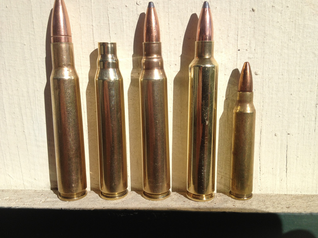

Here's a picture for comparison purposes. First, a 30-06, next, a .25 Gibbs case formed with shoulder, next, shoulder and bullet, then completed round, and a .223 for comparison.
I did not make these cartridges; they came with the rifle and dies when I got them, and the 7 or so stepped and loaded cases I got have split when I tried to form them. I haven't fired the finished case, as it is the only one I have, and want to keep it for measurement purposes.
