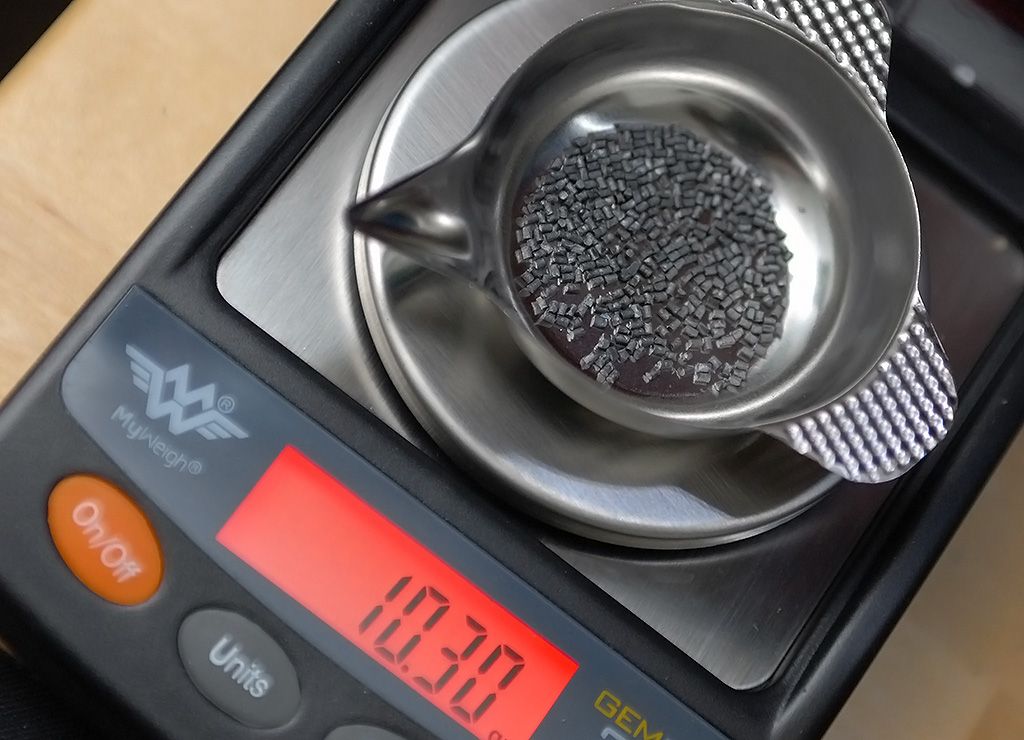

Picture of SeattleDude
Can you guys tell what powder this is?
It came loaded in 300BLK with 220gr bullet.
Posts: 611 | Location: W.WA | Registered: July 13, 2009Reply With QuoteReport This Post

Truth Seeker
Picture of StorminNormin
Are they factory loads or reloads?
I would expect a 220gr to be loaded with A1680 but that powder is definately not any of the 300BLK powders I use which are A1680, H110, and Lil' Gun.
So I have no clue as to what powder that is.
NRA Benefactor Life Member
Posts: 9922 | Location: The Lone Star State | Registered: July 07, 2008Reply With QuoteReport This Post
Could it be IMR 4227? Most of my Dupont powders are stick like that.
1 John 1:9
Posts: 66 | Location: Michigan | Registered: November 01, 2014Reply With QuoteReport This Post
