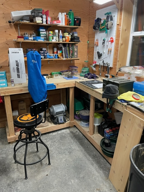

39" is perfect for me. I can stand if I want or use the stool if I want. Kind of messy, but this is mine:

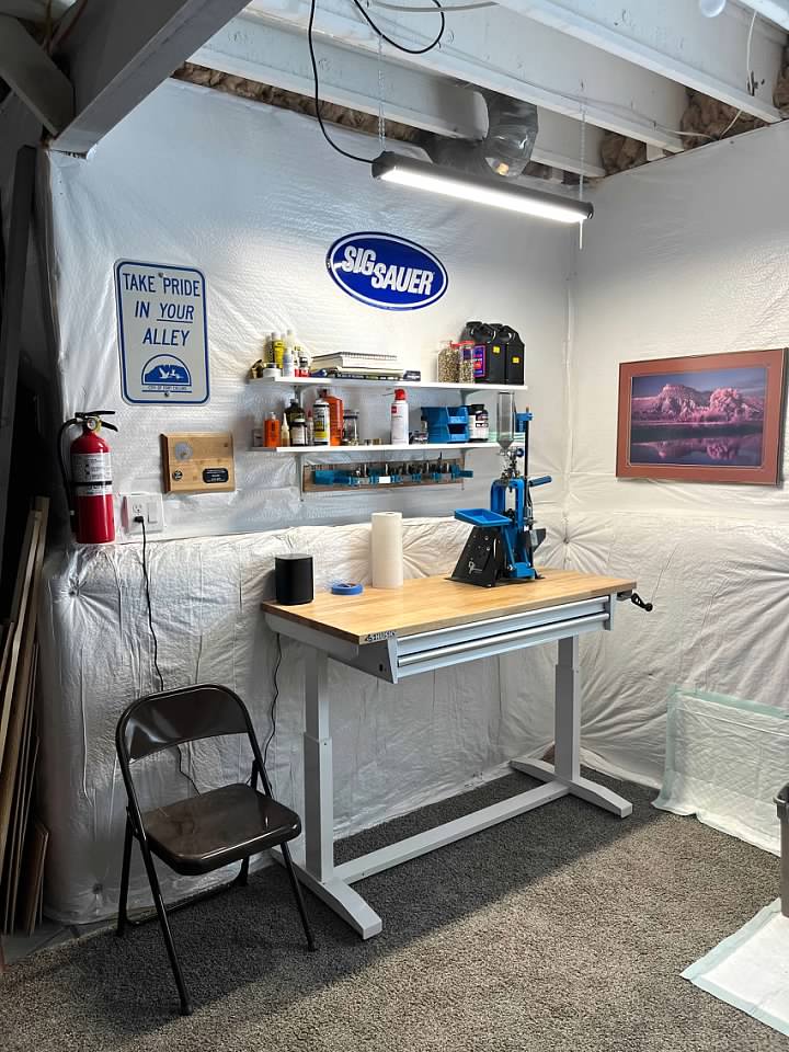

I picked up one of the adjustable Husky tables from Home Depot a couple years back.
I admit, the table is shaky when loading, but I like the option of sitting or standing when loading.
One thing I do to stop the shaking is to hold onto the bullet tray when operating the piston.
Also note how the press is on the edge of the table and not the center. That helps with the table movement.
Posts: 5960 | Location: Colorado | Registered: April 20, 2009Reply With QuoteReport This Post

That is one of the more unique loading setups I've ever seen. Are those mattresses behind and to the right of the bench?
This Space for Rent
Picture of ugeesta
Foundation insulation. I reload in the basement. The press is sitting back too. I move it forward to the front of the table when using it.
So do you C clamp it to the bench or what?

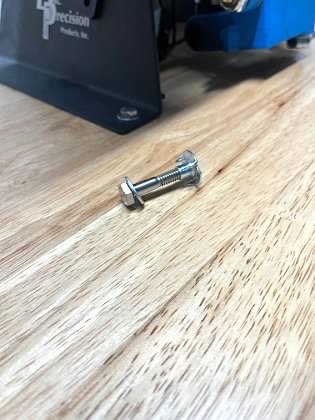

No.
The stand is secured in place by using machine bolts with tee nuts under the top. Its easy to move the press so I can use the table for other hobbies.

Picture of the Tee nut
