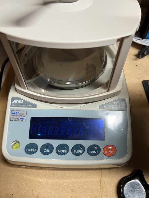

I just got an A&D FX-120i that I will likely pair with an Auto Trickler in the future.

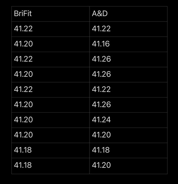

Decided to test the accuracy of these scales against the A&D.
Loaded 10 loads on the cheap BriFit scales and then measured them against the A&D.
Found that the maximum reading difference between the cheap scales and the A&D was .06 GN. That is between 2-3 kernels of H4350.
All in all, around 1/2 a tenth of a grain is excellent accuracy for $15, I probably won’t see much improvement in my loads with the expensive scale other than peace of mind until I add the Autotrickler for efficiency.
