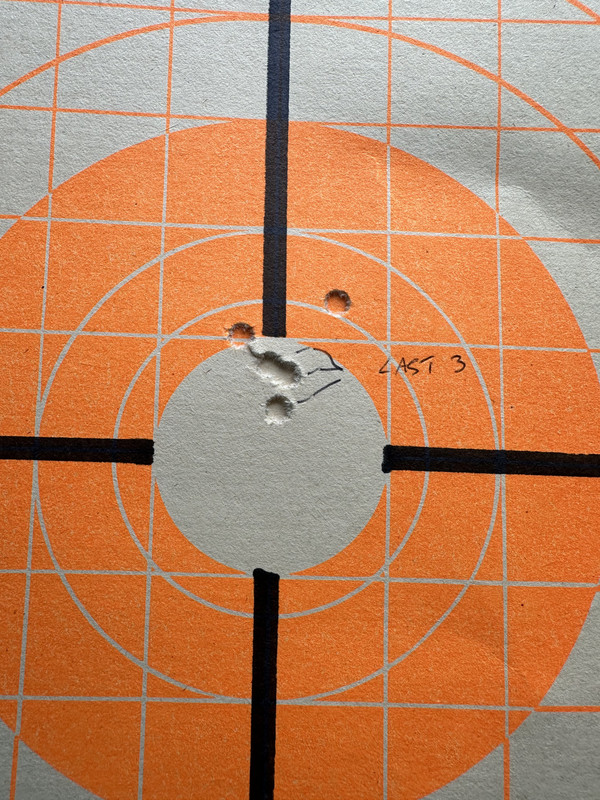

I have another antelope hunt coming up in a few weeks. I shot factory Hornady loads the last two years, but decided it was time to do my own. I went with Hornady 90 grain ELDX, 43.5 grains of H414, Winchester cases and large rifle primers. I experimented with powder loads in .5 increments and 43.5 settled down. Neck sized the cases as well. I go slow and hand weigh each one. Can't wait for the hunt.
I am using a Ruger M77 with bull barrel. I had to shoot using just my readers to get everything in focus at the range, but out hunting my regular glasses will do just fine. Leupold 4 x 12 does a great job too. I wish I had my 25 year old eyes back...

Sounds like a great load for an antelope hunt.
