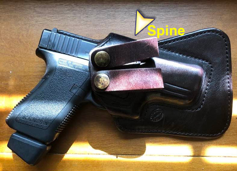

Picture of 4MUL8R
What is the "spine" of a holster, please?
If the operation could be restated as "top of slide" or something similar with a point of reference, that would be super.

Picture of toxophilus84
Image illustrating the spine on a holster... think of it as the top of the firearm where you typically would use the sights Wink
