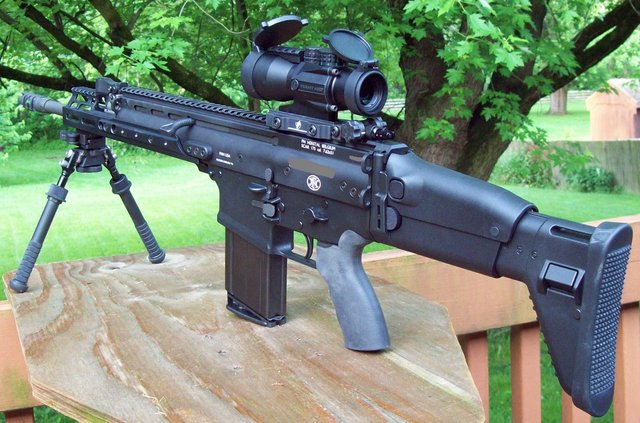

parabellum
Cool as it is, I wouldn't bother with the short barrel. Aside from the tax stamp for it, you lose a whole lot of the energy of the 7.62x51mm.
I would, however, get rid of the muzzle break, if FN is still putting that monstrosity on these rifles. Opt instead for a standard flash hider. Lots of good choices. My SCAR 17 wears an AAC Blackout non-mount FH, which you won't be able to find new, I imagine.
FN's stock trigger is heavy and very creepy. Despite the fact that I am permanently pissed at Geissele for their bullshit COVID policies regarding their employees, they make what has to be the very best trigger for this rife, the Geissele Super SCAR. Perhaps these days there's an alternative, but this is a fantastic trigger.
The Parker Mountain Machine rear sling mount is a must have IMO.
For a front QD mount, I used Damage Inc's extended rail, though I think this is no longer available.
With those two items, you can get this kind of QD sling setup, here shown with my go-to sling choice, the Blue Force Gear VCAS.
The thing about the Damage Inc extended rail is that installing it requires that you remove the barrel, and there are torque specifications for the barrel which you must not ignore. For this, I used the Borka Tools PTL062. You will need this or some other precision torque wrench if you plan to remove your barrel. Torque specs for the SCAR 17 barrel can be found online, as well as the torquing sequence for the screws.

1flynDO
Para and pace 40 what grip do you have?

parabellum
That's a TangoDown grip, which I've since switched to a Magpul MOE+, modified by PMM, if I recall correctly. You may be aware that AR grips won't quite seat on the SCAR lower. They require a bit of material removed.
The TangoDown is a bit thin for my tastes, and the Magpul MOE+ is perfect.
**edit**
Yeah, here it is: PMM SCAR 16/17/20/SC Magpul MOE + Grip
