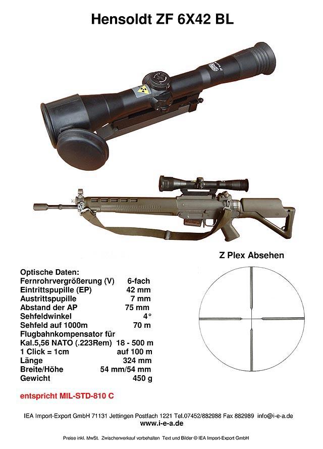

Picture of MG34_Dan
Originally posted by kimberkid:
I just wish they had gotten a 6x like MG34_Dan’s!
I got one from IEA back when they offered some for sale. The other came from a private sale up in Dallas.
http://www.mil-optics.de/36/ZF...h0n93q4efhidihcul843
Posts: 2233 | Location: Austin Texas USA | Registered: February 03, 2007Reply With QuoteReport This Post
Picture of kimberkid
Not sure if you noticed but my mount is exactly like the one in your picture above!
Posts: 5765 | Registered: January 11, 2007Reply With QuoteReport This Post
Picture of MG34_Dan
Yea, I saw that. IEA was also selling them NIB for 400 Euros.
SIG-Sauer
Anthropologist
They can be had between 300 and 400 depending on the adapter type. The base is about 250 the adapter is about 150 depending on type, if it’s STANAG, Weaver, Picantinny, Zeiss or Trijicon.
