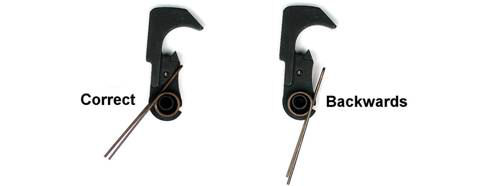

Last evening I mounted my Vortex Strike Eagle 1x8 using a Vortex cantilever mount and took it to the range this morning. It is a very impressive piece of firearm, very sturdy and well machined. However for the life of me I can’t figure out why Black Rain Ordnance wouldn’t put a decent trigger on it! It is heavy, with lots of travel and tons of creep. Very difficult to shoot accurately with it. The trigger on my Ruger MPR is way better, at less than half the price. I will give it some time before making a decision to replace it. It is a very soft shooter for a .308 and has lots of potential for being very accurate.
I wish I could report that it ran 100% for me today, but it didn’t. I suffered several (6-7!!) light primer strikes and a few FTE in just about 20 rounds fired. After a few light strikes I removed the bolt to make sure I had assembled it correctly (I had) and then removed a chunk of brass from under the extractor. It seemed to improve somewhat at first but still was not reliable. Part of the issue may very well be that I was shooting Aguila 7.62x51 ammo through it which has proven problematic for me while trying to shoot it from my .308 M1 Garand. It appears to be marginally weak ammo. The only semi-auto I own that will shoot it reliably is my M1a. I did switch to some .308 reloaded ammo (using Lapua brass and 155 gr Lapua Scenar bullets) acquired from the CMP which had been 100% reliable, but still experienced a couple of light primer strikes with it.
Can’t really condemn the rifle at this point as I know I was shooting ammo that isn’t the best initially. The light primer strikes are a concern though. Every round fired on the 2nd try. Better ammo and some judicious breaking in may resolve some of these issues. If not then I will contact BRO. The rifle was cleaned and lubed before going to the range although I probably could have done a better job making sure the chamber was spic-n-span. The gas block isn’t adjustable so shooting the Aguila ammo isn’t an option with this rifle, at least until it is ‘broken in’. Time will tell.

If you're getting light strikes on an AR, the first thing to check is whether the hammer spring was installed upside down.
The legs should be on top, not on the bottom.

Your light primer strikes are definitely disappointing. I don't recall experiencing them on centerfire ammo, thus I am doing some guessing here.
IMO there shouldn't be a break in period on an AR10. Clean & lube the BCG. Make certain there's a bit of oil on the firing pin, and that the firing pin goes all the way forward. Meaning that it can really dent a case. It's possible that there's some gunk that doesn't allow the firing pin to move all the way forward. You can check & clean the chamber, although I wouldn't bet that's the root cause.
I've heard people state that some military primers are really hard, which can lead to light strikes. I don't know if that applies to the ammo you used.
I know nothing of BRO triggers. I have a Wilson Combat single stage in mine -- it is outstanding.
Thanks.... I will check that, but I didn't take that apart.
