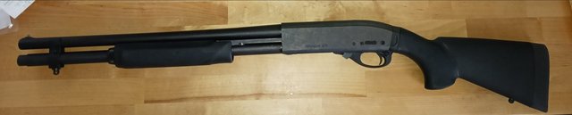

I won! Or maybe I'm just too stubborn to take it to someone asking for help.
I had to walk away from the project for a couple of days, and finally got back to it today.
The little beast is finally reassembled, and I think it looks pretty sharp with its new Hogue goods.
Now to get it into TLG's hands for some destroying of paper and clays.... Cool
