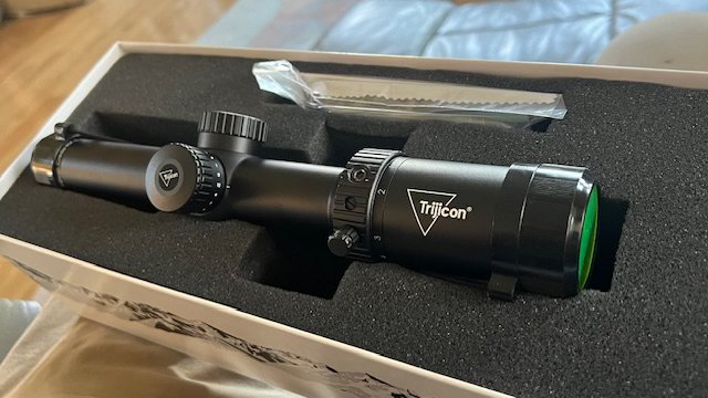

I need to get ordering because the brown truck just showed up!
I ordered this from Europtics yesterday morning (Wednesday) and it's here the next morning! Awesome service Euro!
