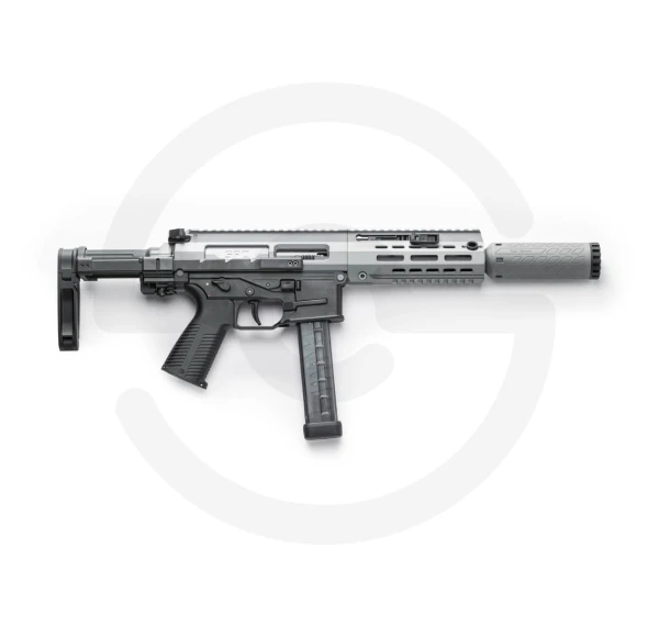

Good thing you didn't grab the SPC 9. They just released the SPC9 SD2. Looks hawt.
