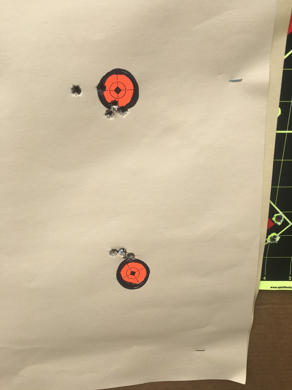

I built this upper using the following:
1. Ballistic Advantage 8.3” Hanson Series Barrel
(comes with pinned gas block installed)
2. Aero Precision Upper
3. Aero Precision Rail
4. Spikes pistol length gas tube
5. ToolCraft Black Nitride BCG
6. Leupold VXR Patrol with Larue Mount
7. KAK Linear Comp
8. SWR Trident 9 (for suppressed use)
GraniteRidge has a great sale on all the items right now. It is a very accurate ultra reliable upper
My lower is a SBR RRA with Larue MBT Trigger.
50yd groups with my handloads that I was testing. Each group was 5 shots. The bottom group is Hornady 110gr VMAX and my new hunting/Home Defense load.
Posts: 1273 | Location: Orange Park, FL. | Registered: November 26, 2000Reply With QuoteReport This Post
