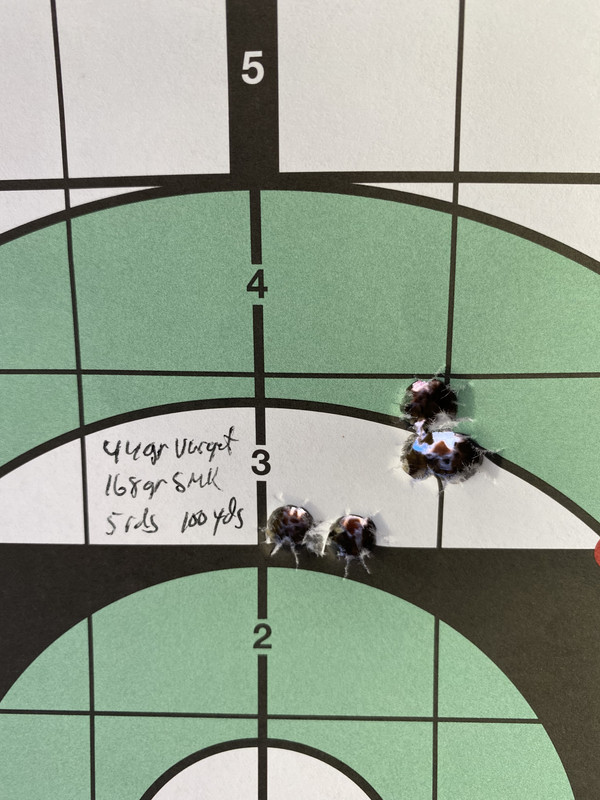

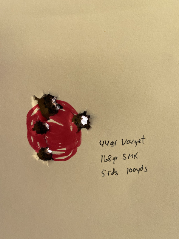

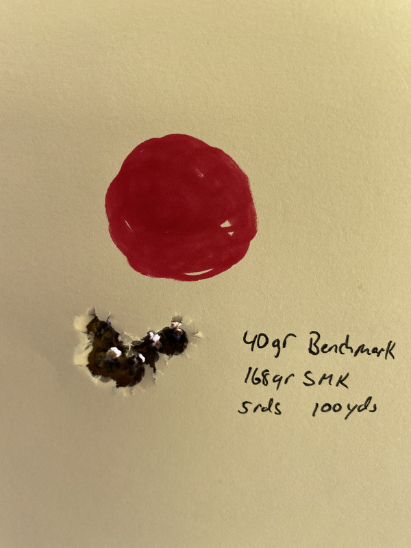

I was finally able to take my Noveske out for some accuracy testing today…..(Covid kicked my butt for the past two weeks). Anyway, the gun shot well using two different hand loads. One was 44gr Varget with a 168gr SMK and the other was 40gr Benchmark with 168gr SMK. Groups were around 1” or smaller. This is not a bench gun, so I felt the groups were very acceptable for a 16” barrel and 10x scope.

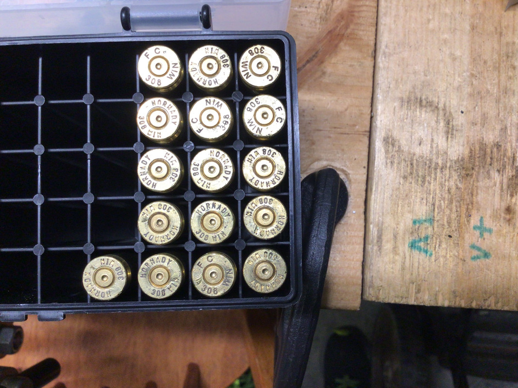

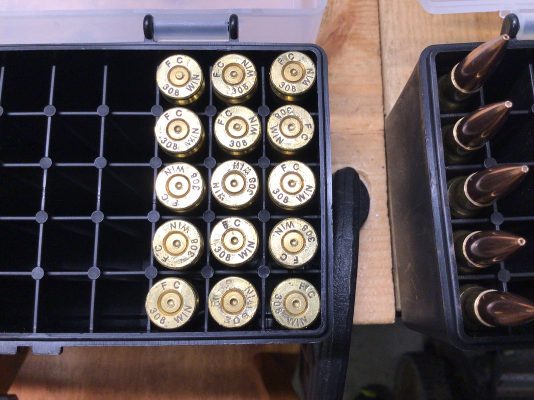

Got a pic of the ejected cases with the primers showing?
Here you go. Thanks for your help.
Some definite high pressure signs, IMO.
Primers that are flattened (I believe) and cratered (clearly), and perhaps even some marking and “smearing” of the headstamps.
People tend to worry about bullet setback’s causing high(er) pressures, but in rifles like that my experience has been that it’s more likely to be caused by the bullets’ contacting the rifling before firing. If it’s a tight chamber, the leade may be a little shorter that what you’re used to.
A simple way to determine that is to load a dummy round, blacken the bullet with a match or other sooty flame, chamber it, and then inspect the bullet for rifling marks. If it’s touching the rifling, I would seat the bullets a bit deeper.

The primers look just fine.
44gr of Varget for a 168SMK is just fine, mid-level load.
I think that was not virgin brass, probably many times loaded.
Do you have a case guage for .308 Win? If not, why not?
My guess is that the brass was fired in a more generous chamber and then resized. It has been my experience that even using an SB die after the brass has been fired in a larger chamber a couple of times, the base will NOT be brought back to original.
My experience has been that with a tight chamber, used brass won't work well; it will load fine, the bolt is big and heavy with quite the spring behind it. But when trying to eject, I have had the extractor jump the rim and leave the case in the chamber. You're lucky that it only grabs and holds an unfired round, which must be mortared off.
Get the guage and drop in your loaded round. If it doesn't go flush by itself, you have your problem. The only solution is to use virgin brass and ALWAYS use the SB die for full length resizing after every firing.
You can also measure the OD about a half inch above the extractor groove. It will be > .473 inch.

Thank you for the sound advice. I have a case gauge and the loaded rounds drop into it just fine. You are correct in that the brass is not virgin brass. It was fired in my LMT which I think does have a generous chamber. It has also been loaded a few times. I’ll just buy new brass and fire form it to my chamber and go from there.
