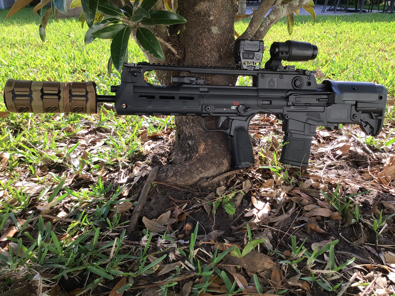

I had one with the 16” barrel. The gun was extremely accurate and a great suppressor host.
The downsides were ergonomics. It was like holding a block. The trigger was heavy as heck. The length of pull was ridiculous and the height over bore was crazy as well. I traded mine off for a Socom 16.
I have a 16” one, and it’s fine. Upgraded it with the Manticore Arms curved buttpad and Lunartech Designs safety levers (the safety levers were very hard to reach on one early ones, but revised on later ones). I don’t find the trigger particularly heavy.

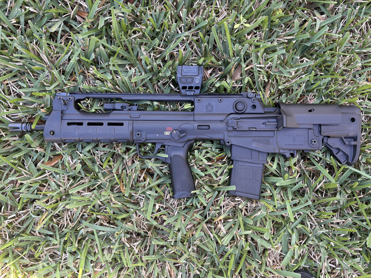

Mainly because you were using an AR-height optic mount...
The Hellion's raised top rail necessitates a low mount, just like any other rifle or shotgun with a drop comb stock.
(As opposed to something like an AR, whose stock is in line with the top of the receiver and thus you need a ~2" optic mount to raise it up to eye level.)
For example:
T2 on Hellion with low mount:
T2 on AR with AR-height mount:

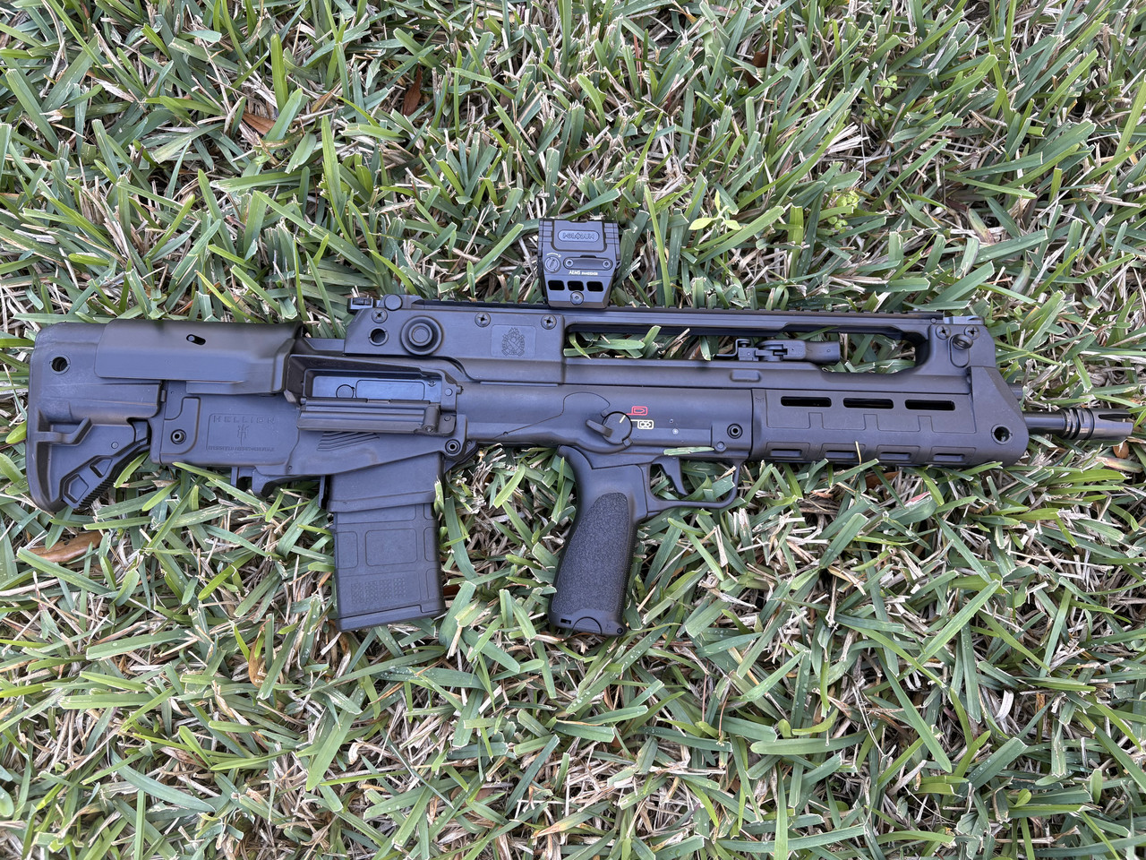

Acro on Hellion:
Acro on AR:
MRO on Hellion:
MRO on AR:

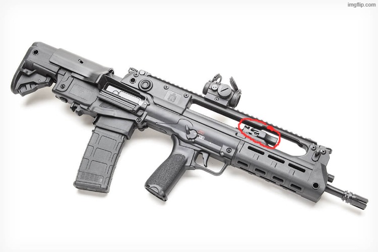

What's the circled object?
Posts: 32305 | Location: Johnson City, TN | Registered: April 28, 2012Reply With QuoteReport This Post

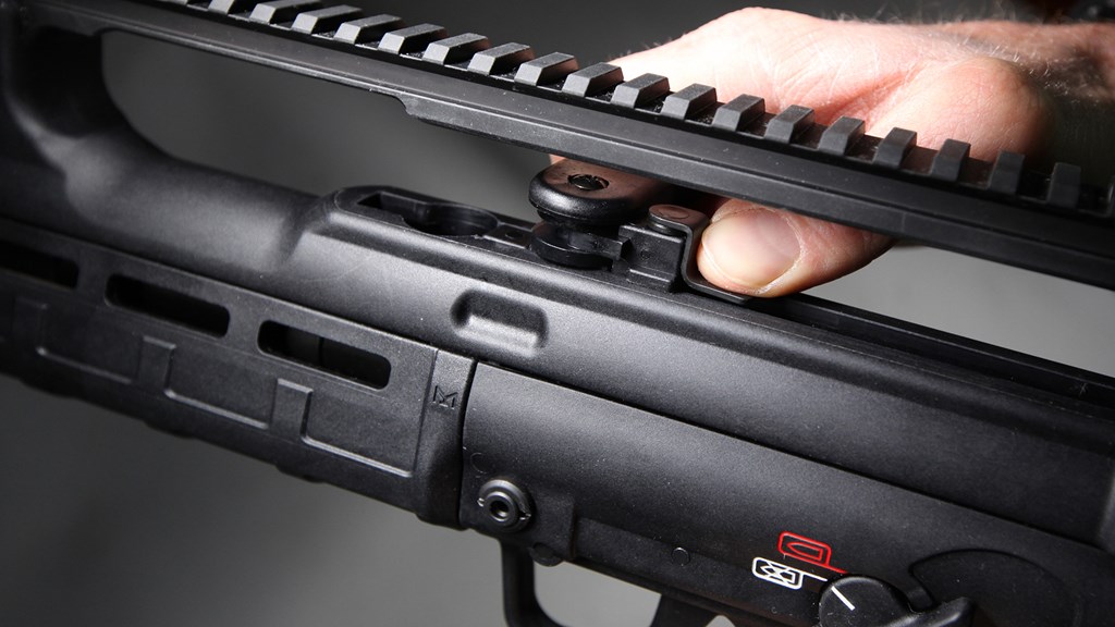

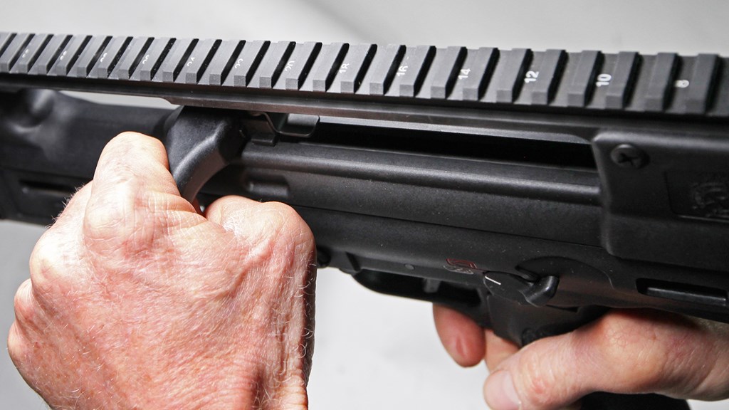

Charging handle. It folds horizontally out to either side for ambidextrous use, then it's spring-loaded to fold back flat and of the way when not in use. (Similar to the G36.)
Posts: 35655 | Location: Northwest Arkansas | Registered: January 06, 2008Reply With QuoteReport This Post
A bit of a stretch for one's arms. And that's a long distance between the charging handle and the action proper.
Your support hand is already out past there.
And find me a bullpup design who doesn't have the charging handle in about the same spot, ahead of the action. (Well, one that isn't just a bullpup conversion of a standard rifle.)
Again, bullpup. The trigger is about the same distance from the action too. Long linkages between action and controls are what bullpups necessarily do.
Besides, there are normal rifle designs with the charging handle ahead of the action by the support hand too, like the HK roller locked family, or the CZ Scorpion, or the aforementioned G36.

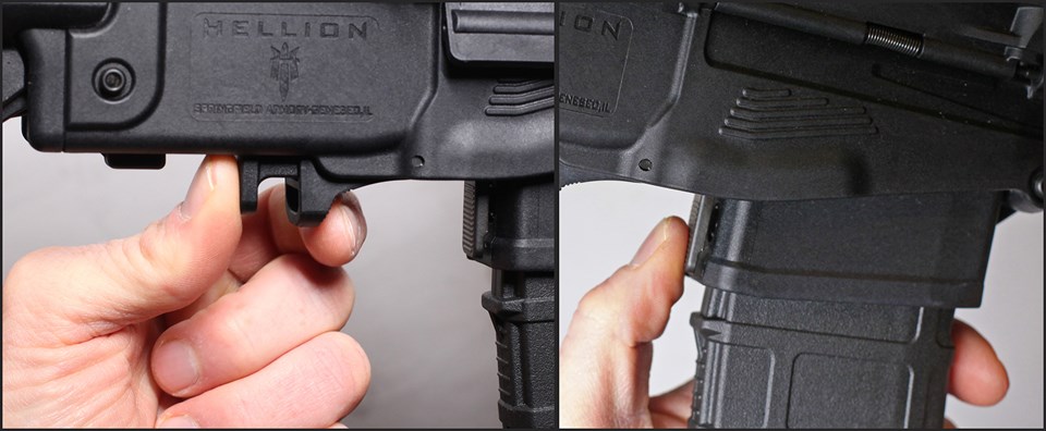

I handled one at the local store and I can't understand (maybe all bullpups are like this) but there is no external bolt catch lever. The only way to to lock the bolt back is to insert an empty mag in the magwell and pull the charging handle back or reach your hand in the magwell and push the bolt catch up while pulling charging handle back.

Actually there's little nipple behind the magazine that allows you to drop the magazine, and I'm pretty sure if you're holding it you can lock the bolt back with it using the charging handle.
