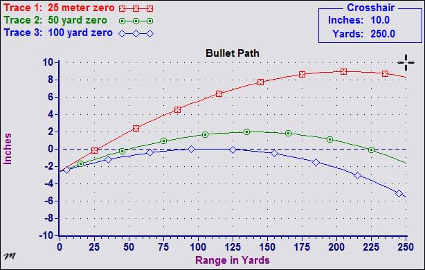

Here is a chart showing the trajectory of a 55gr 5.56 or .223 bullet. As you will see, sighting in at 50 yards you will be good out to around 225 yards.
I also use a bipod with rear sandbags.
