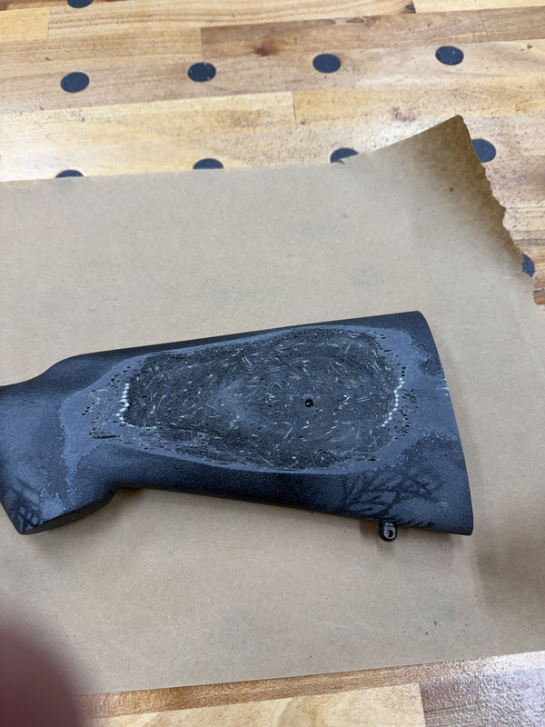

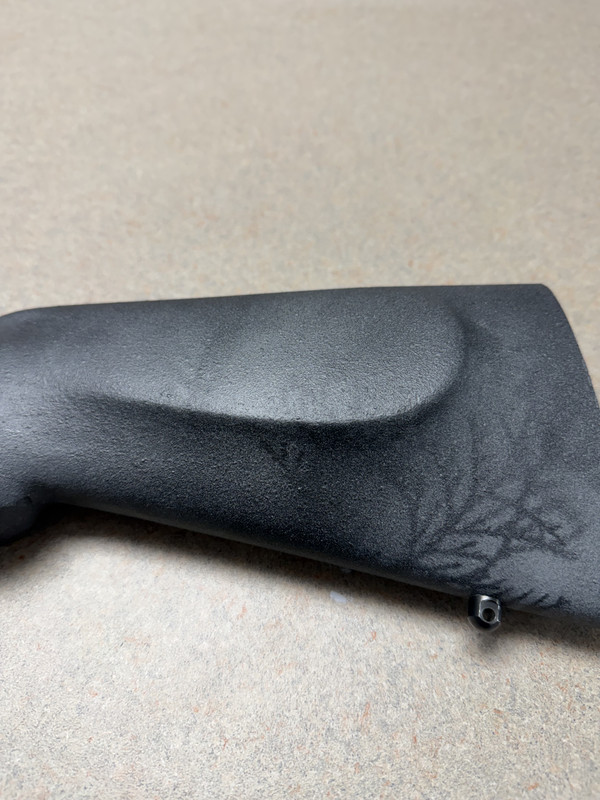

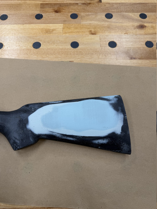

Well, here's the after action report. I took the cheek piece off with 80 grit sandpaper on an orbital sander. Cleaned the area and applied fast set Bondo. Sanded to contour and primed with Rustoleum auto primer. Next used Rustoleum black texture paint and gray accents through fake vegetation from Hobby Lobby. Final sealer with Rustoleum Matte Clear.
Certainly not professional results, but I'm pleased with the outcome. Scope alignment is now right where it should be.
