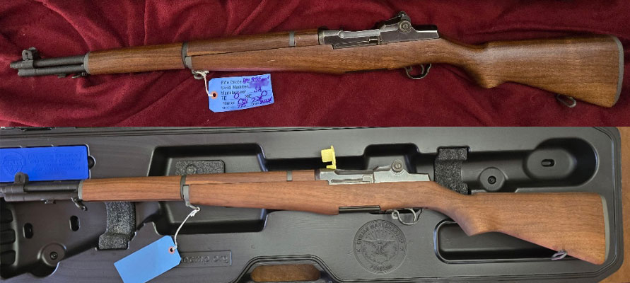

Zombie Thread, re-resurrected after stock finishing.
Turns out my son is an engineer with a millwork firm, and they have a professional wood refinisher subcontractor who took on the refinishing with Polane 2K acrylic polyurethane
Picture below shows a picture of the rifle assembled after wood finishing, above the picture of the rifle as it came brand-new from CMP, for a before-and-after comparison. The picture doesn't do the wood justice... came out nice! Smile
Posts: 15814 | Location: North Carolina | Registered: October 15, 2007Reply With QuoteReport This Post
That came out very nice! I have two CMP Specials in 308. Very nice shooters!
