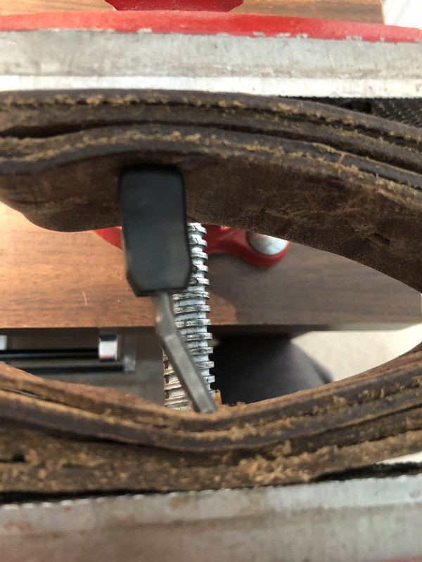

I removed the broken grip from the charging handle using a small vice. When clamped down, the handle shattered and fell off the charging handle stem. Interestingly, I needed to remove the remnants of the dried old glue that held the original grip in place. That's the coffee colored stuff shown below.

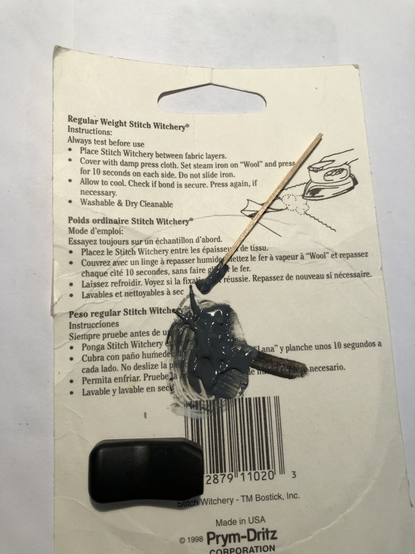

I mixed up a little JB Weld and got the new grip handle ready to glue.

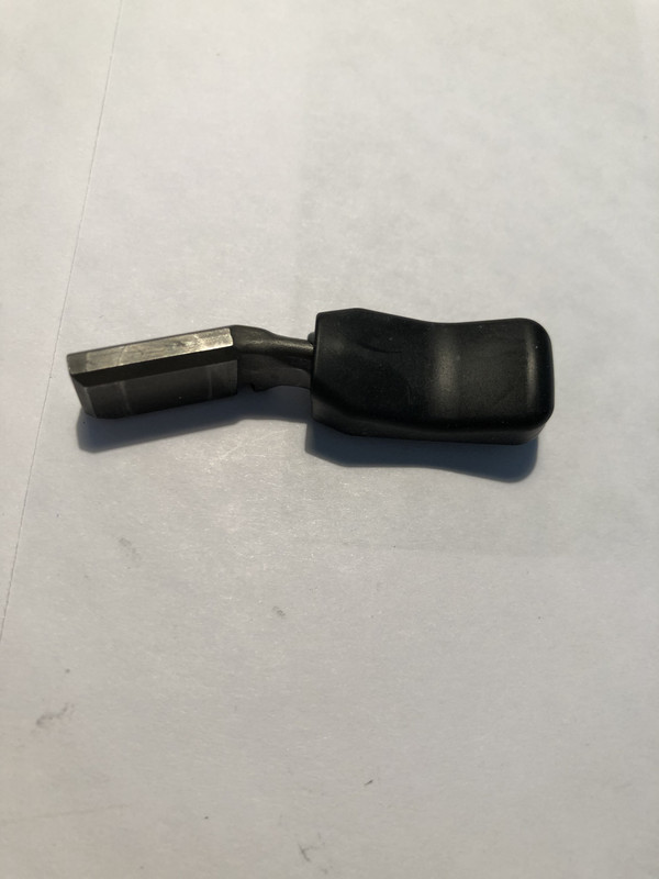

I gooped up the charging handle stem with the glue and slid the new grip in place. I then used my vice to firmly hold the handle in place. I let everything sit for 24 hours.
This was my outcome. All looks OK, in my opinion.

Congratulations. You are the owner of the most expeinsive item SIG has ever sold. I think it´s value is around 8000$ per pound. A pound of an engraved Swiss P210L is only worth a fraction. Wink

The furniture is made of nylon 6 type material. Polymere type pistol frames are made of a similar material

Dan, the knob is made of hard rubber, not plastic. It dissoves when its in contact with mineral oil type gun lubes. Silicone is recommnded to protect rubber parts. I learned it the hard way also.
I was probably cheaper to use a 5 cent part then additional machining on 600000 chargeing handles. Designer of the rifle was Mr. Bordbeck and his team.

I was under the impression that the rubber cocking handle cover is a press fit, does not require epoxy.

The replacements I got definitely were not press fit. Maybe the factory originals were press fit. But either way, there was dried glue present on the charging handle shaft under the broken handle. It is the coffee colored crap in my picture two above.

I tend to like SikaFlex 221 for this as that's what auto manufacturers use to bond plastics to metal like a shift knob.
