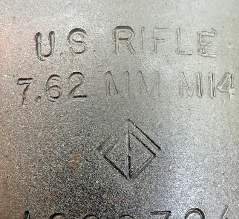

I’m a complete newb when it comes to the platform. Today I saw what appeared to be a camo painted M1A. Upon closer inspection, I saw this.
I didn’t see any selector so it’s obviously not a giggle gun…
, but is this something special or were converted M-14 receivers a normal thing? Other than the scope, mount, and plastic stock, all else seems factory to my eye. Thanks in advance.

Isn’t it common for manufacturers of the rifles these days to call them M14s (even though they’re not)? As far as I know Springfield Armory was the only manufacturer to honestly give their civilian versions of the weapon a different model designation.
It’s like Colt marking some of their AR-15 type rifles “M4.”

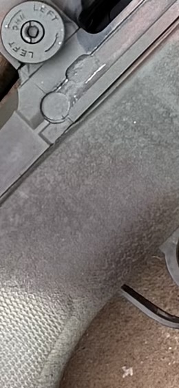

FWIW, though, not seeing a firing selector that permits full auto fire doesn’t mean it’s not a real M14. The selector is a separate part that was seldom actually installed and used with the weapon. I saw real M14 rifles in basic training, in Vietnam, and much later at my agency, and none had the selector that permitted full auto firing. The stock you pictured does not have the cutout to permit the selector to be installed, but GI stocks did even though selectors were not normally used.
Good question, though, and now I’m curious because although I noticed the marking practice, I never looked into it.

The thought that a manufacturer actually stamped it M14 never occurred to me. Where the selector enters the receiver is flat metal so it appears to be manufactured as a semi-auto. I’ll have another look at it soon and can see if I missed any other possible marks.

Ok, an image search on the first pic shows it was made by Springfield Armory, so given all the supporting evidence, it looks like a converted M14 receiver?
Posts: 16536 | Location: Martinsburg WV | Registered: April 02, 2011Reply With QuoteReport This Post
Now I’m confused.
Based on a brief Internet search, Springfield Armory, Inc. does not use the “M14” marking. But maybe that’s changed.
If I understand the law and/or ATF rules correctly, converting a real M14 receiver to turn it into a non-NFA gun would not be legal: Once a machine gun, always a machine gun. But I could be wrong.
Where are our experts? Wink
Added: This is what I found about the law.
"A firearm originally manufactured as a machine gun remains a machine gun forever, regardless of later modifications."
The Springfield Armory government facility (not the commercial Inc.) did manufacture real M14 rifles, but if what you are seeing was made by it as a real M14, then it is a machine gun that should be registered under the NFA.

I believe that is potentially an Armscorp made receiver or at least is marked with a logo meant to imitate the Armscorp logo.
Yep.
Armscorp made investment cast receivers, similar to Springfield Armory, Inc's M1A. Armscorp also made a bunch of Fulton Armory's early receivers. Some good, some bad. Some of the old-timers won't work on Armscorp receivered rifles due to too many issues. Some report zero issues and like them.

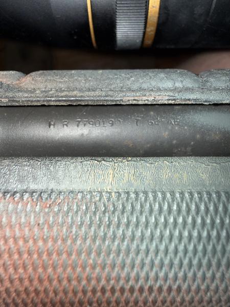

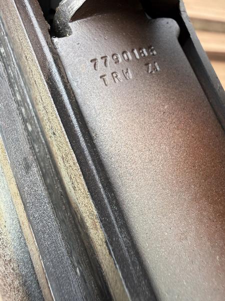

No idea; the only things I can see numbered are the TRW bolt
and this on the barrel
It also wears a Sadlak scope mount (appears pricy) and a Leupold Vari-X 8.5-25.

I thought Armscorp rifles were marked M14NM, at least mine is.
Bolt is USGI made by TRW. Barrel is likewise and made by H&R. The trigger housing and several of the trigger group components and the operating rod would also be marked if USGI or commercial (depending on the manufacturer).

It's an Armscorp receiver. That rifle was never a full auto M14.
The ATF was more picky back in the day when the commercial entity we know as Springfield Armory, Inc was formed. They wanted to use the M14 model designation, but the ATF wouldn't allow it, so they settled with a capital A, which resembled a 4.
M1A is a model trademarked by Springfield Armory, Inc (not to be confused with the government Springfield National Armory that shut down in 1968-ish). But since SAI was the only company making M14 clones for a long time, and now they're at half a million, most people refer to our rifles as M1A's.
I personally use the generic term M14, since I don't own a M1A. My LRB rifles are marked M14SA, M14NM, and M25. My Bula rifles are marked M14, M21 DMR, and XM21.
I have a customer receiver from James River Armory marked M14 NM.
Over the years, the ATF has relaxed their model designations and allowed the model M14 to be used for semi-auto commercial M14 clones.
That rifle seems to be built with good GI parts and has a TRW bolt and a H&R barrel.
At some point, James River Armory was using Bula receivers with cut heels and welding GI M14 heels onto the Bula receivers. It was still considered a James River Armory rifle, but they had heels from TRW, Winchester, H&R and Springfield Armory de-milled rifles.
Armscorp receivers had notoriously wide operating rod shelves which hindered the ability to install a fake selector switch.
As a side note, SAI, Armscorp, and Fulton Armory receivers are investment cast.
LRB remains the only company to offer a true-to-print (as much as the ATF allows) M14 receiver which is hammer forged.
Bula receivers were press forged and there's another company in Tempe, AZ (who's name I never mention) who produced receivers machined from billet steel. I'm not sure how JRA/H&R/Palmetto State Armory makes their receivers.
To my knowledge, JRA is making the M14 receivers in house for PSA under the H&R trademark, which they bought.
Tony.
Posts: 5974 | Location: Auburndale, FL | Registered: February 13, 2001Reply With QuoteReport This Post
