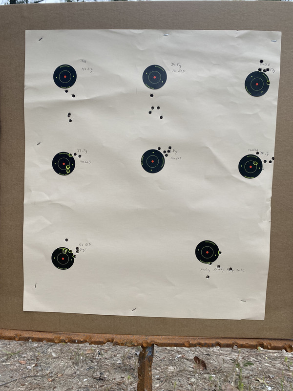

I was able to take the gun out last week with Hornady 147gr ELD Match and 140gr Hornady Black (both factory loads). The groups with the stock trigger were averaging 1.5-2” at 100yds. That is just not acceptable to me personally. This morning I dropped in a Larue trigger, cleaned the barrel and loaded up some 140gr ELD M, starting at 36gr H4350 as per Hodgdon’s starting load and working up in .5 increment up to 38.5gr. As you can see, it did not start out well at all. The factory ammo sight-in group was abysmal. By the time I got to 38gr, the groups started to look much better. I think I am going to load some more at 38gr and try that one again.
I also loaded some 123gr ELD’s at 42gr and shot a 7shot group. That one is the lower left group. It seems this gun likes the lighter loads better.
I’m a fairly decent shooter, but this gun is kicking my butt. What kind of groups are you guys getting? This gun is all factory built except for the trigger and Toolcraft BCG.

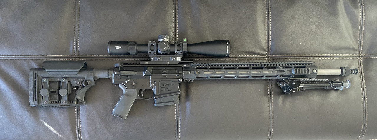

My 6.5CM AR10 has Black Rain receiver set, BCG, and rail. Krieger barrel. I started piecing it together as an F-U to our state legislators during one of their attempts to ban ARs. I intended to use it for semiauto only PRS-type matches, but such matches never really took off. I don't have all that many rounds on the rifle -- unfortunate, as it shoots well.
No pictures of groups on paper or steel. The only groups I've measured and documented were during its first outing -- after maybe 10-15 rounds for barrel break in, MV testing, and scope sight in. I used leftover Hornady AMax for this.
Amax 140 -- 5 rounds in 1.12" at 100 yards. Then 5 rounds in .88" at 100 yards. I stacked 3 or 4 rounds on top of each other, then pulled one or two in each group. There's a lot of mass and gas moving around in an AR10. Much harder to follow through and control the recoil cycle than with a bolt action. I need a day with my A-game working to shoot an AR-10 well.
Amax 120 -- 10 rounds in 1.12" at 100 yards. Most of the rounds were stacked on top of each other, but a couple pulls.

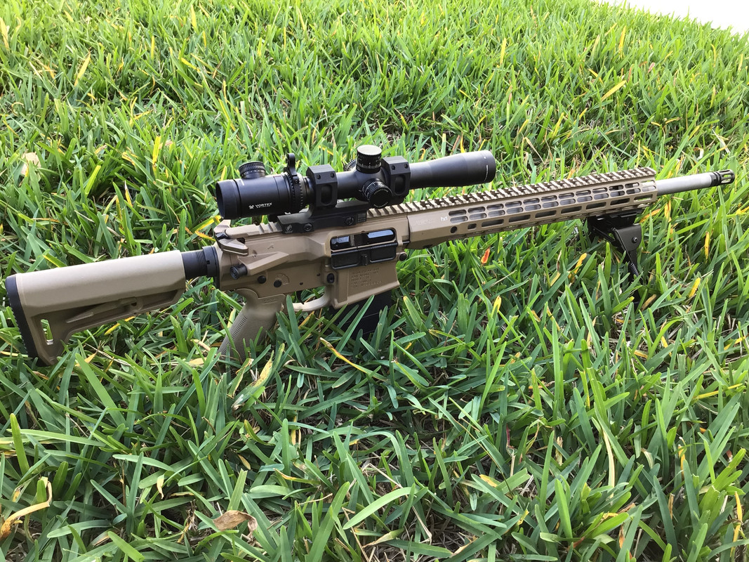

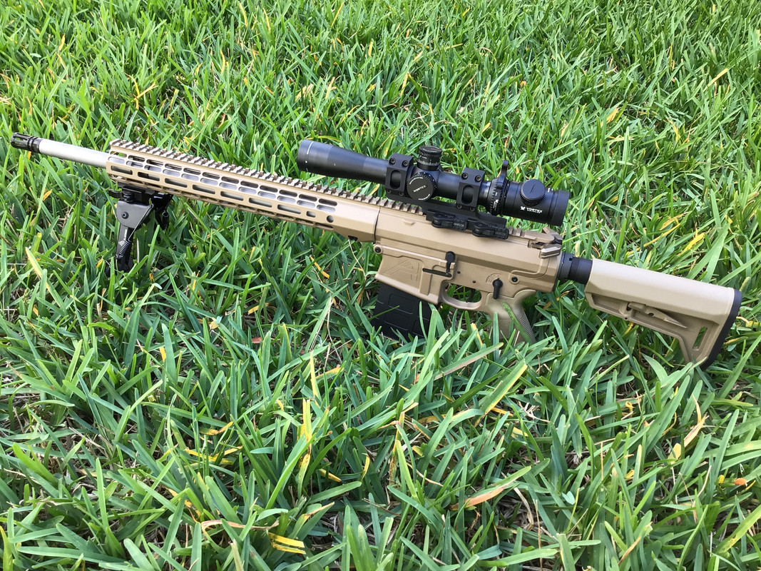

I have a 6CM AR10 that is almost a match to the 6.5CM AR10 -- but with a Bartlein barrel instead of a Krieger. I shoot the 6CM AR10 a bit more accurately. Could be the barrel, but I suspect its the reduced recoil of the 6CM. Here's the 6CM Black Rain.
In March 2020 I shot both rifles back to back. Winds were funky over the two different weekends -- one day 5-15 mph from my 4-7 o'clock, and the other 5-15 mph from my 3 o'clock. It seemed like the 6CM got the better deal each rotation, with the winds being more steady. Vertical variations tended to be an inch or so less with the 6CM, but the gusting while shooting the 6.5CM resulted in stringing shots across the width of the steel plates. This was the refrigerator trophy picture of the day with the 6CM. 2.38" vertical and 4" horizontal at 525 yards. Hornady 108 ELDM.
I walked down to repaint the target, shot again with the 6.5CM, and the horizontal stringing was across the whole plate.
At 410 yards the 6CM held 2.75" vertical with 108 ELDM and 2.25" vertical with 105 HPBT Black. Again, the 6.5CM 140 ELDM had slightly larger vertical variation, but with more horizontal stringing.
At 340 yards the 6CM held verticals of 1.62", 2.00", 2.12", and 3.25". I wasn't thrilled with the pulled shot on the largest group. The 6.5CM had verticals under 3" from what I recall.

Factory ammo averaged about 2”. It could be a new barrel that needs break in. I adjusted the scope after the second group to hit more POA.
To eliminated some variables, I removed the FH and will shoot it with a bare barrel with thread protector. I had a gun that was MOA with a bare barrel and all over the place with a FH. I’ll post results tomorrow.
