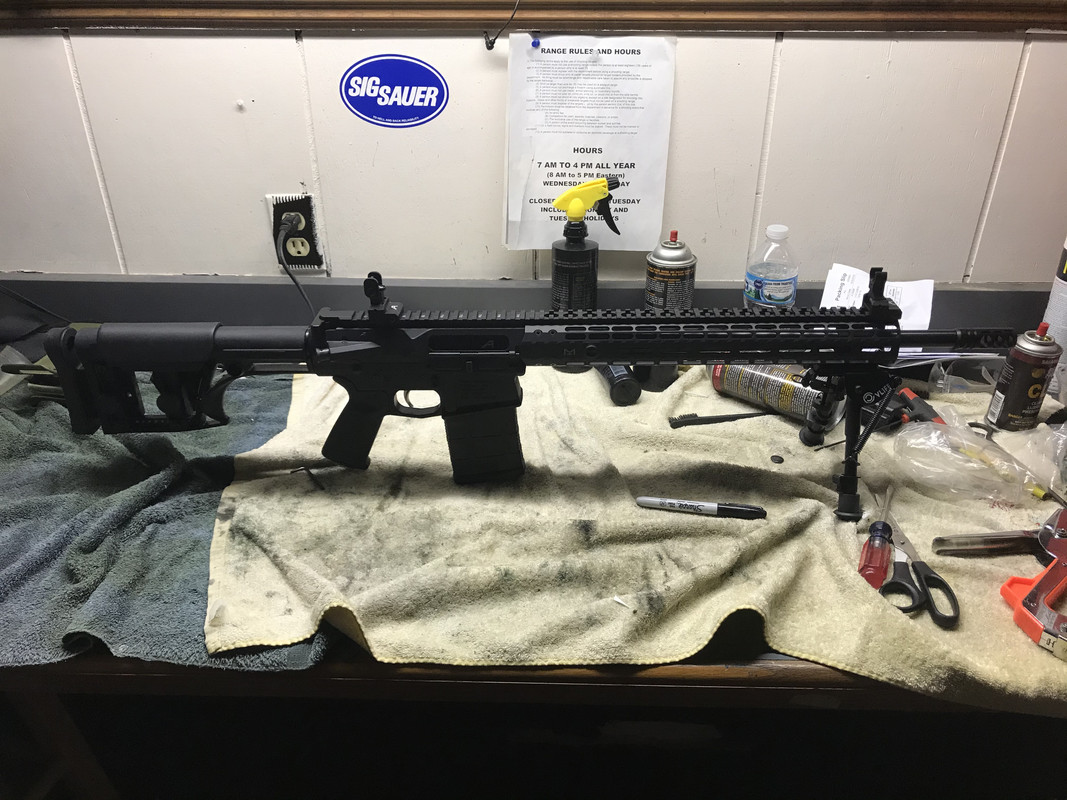

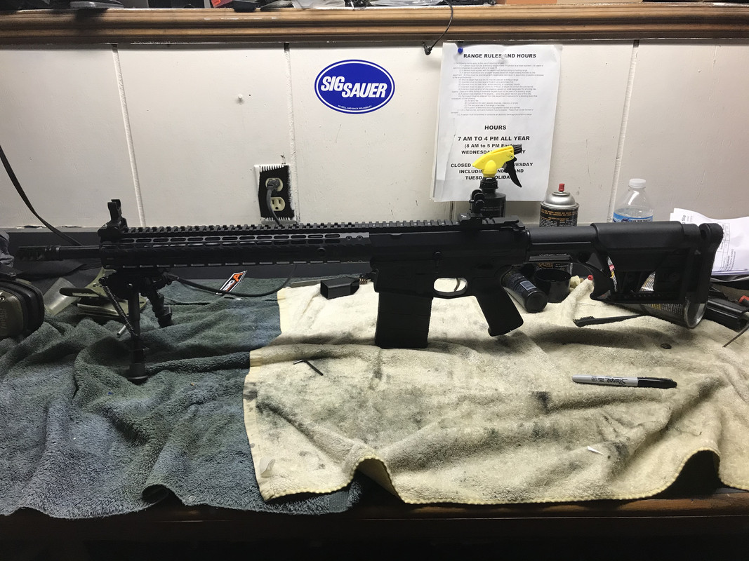

posted November 23, 2019 09:05 AM
Update.... total price was just over $800 with shipping straight from Aero Precision taking advantage of there various sales on BF and the following week. It has a 18” barrel and a 2 stage trigger. I appreciate all the info.
Thanks
This message has been edited. Last edited by: Valpo Fz, December 20, 2019 05:04 PM
