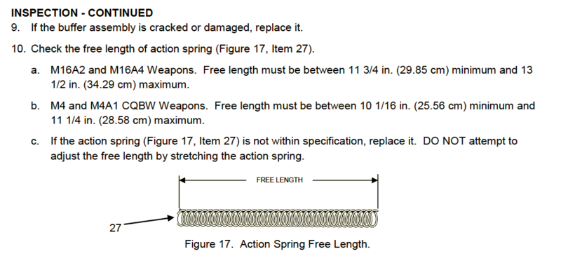

I admit, though, that the buffer springs should probably be replaced more often: what is recommended? (The wear effect nevertheless still started shortly after I acquired the gun.)
Not sure about your other questions but according to the TM the springs are checked for free length.
January 25, 2021, 06:14 PM
sigfreund
Originally posted by mbinky:
[A]ccording to the TM the springs are checked for free length.
Thank you. After I started trying to find the information, I found the same in a manual provided in a Colt armorer course several years ago. It makes sense of course that spring life wouldn’t be based on round counts because that would be virtually impossible to monitor for military and even most LE users. I measured the action spring in my subject rifle and it’s 10 1/8 inches: within spec, but just barely.
Again, thanks to all who commented.
