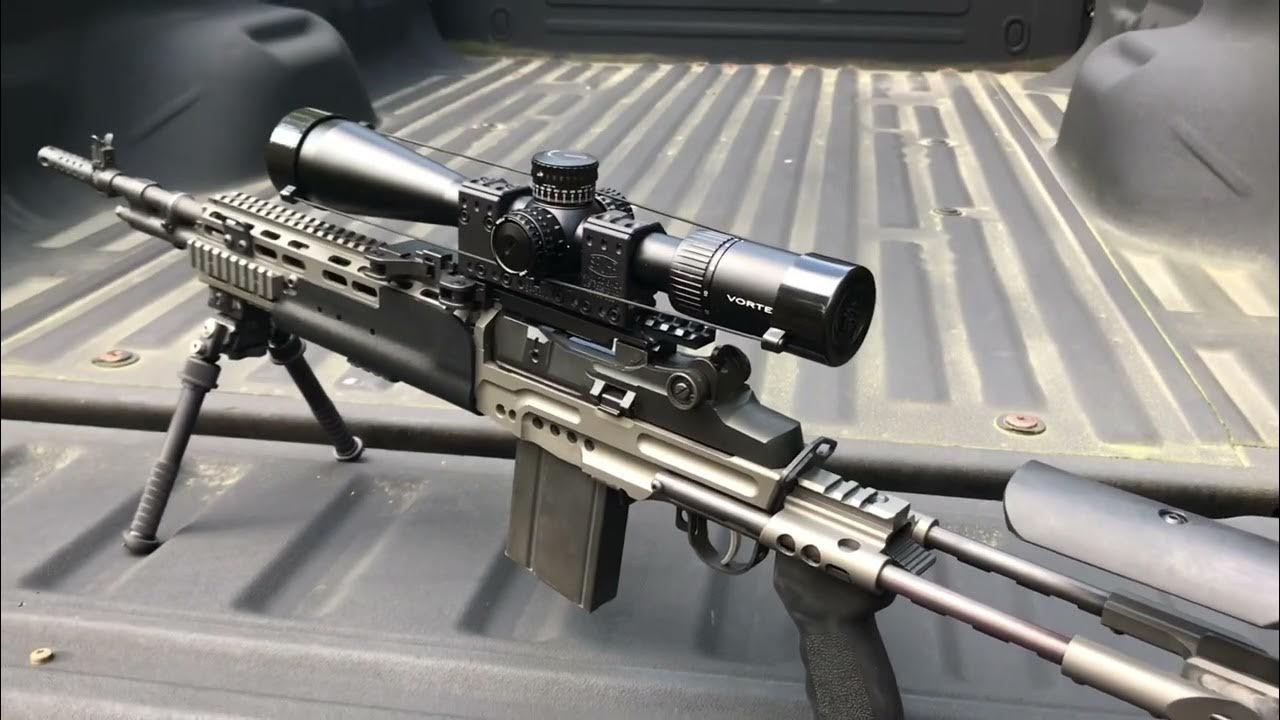

Interesting. Thanks. So what do you make of the reports by SOF that the M14 EBR in a Sage had such significant wandering zero issues any time they were stripped for cleaning? Old, worn out rifles that lacked rear/double lug? Operator error? My friends who speak of their experience with the EBR during deployment are not the operator error types and are great shooters. None felt confident in its ability to maintain zero. Ash Hess speaks of it regularly when interviewed on podcasts.
I was referring to traditional non-chassis rifles in my reply. I'd need more information on the rifle configuration to comment on the SAGE. If they were using the DCSB (detachable cantilever sight base), I can absolutely see that happening. That is the base I don't like from a design standpoint. The sight base is mounted on the front handguard rail with QD throw levers and the back of the mount fits into a index pin that's placed inside the stripper clip guide mount. So you have a front mounting point that's not part of the receiver or the barrel and a back contact point that's touching the receiver, not bolted to the receiver.
The handguard rail is not reference pinned and there's slop around the screw holes. Once you tear it down and reinstall it, there's no guarantee that it will line up exactly how it did before. Plus, if it's not torqued down properly, it may shift under recoil. So you have a cantilever mount that's mounted to a handguard that's not directly attached to the receiver or the barrel.
Now the top handguard has a barrel whip screw that is used to tune the chassis to the rifle. You may have to fine tune it after reinstallation.

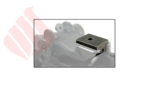

The best scope setup for a SAGE is a scope-only receiver with a scope mounted directly to the receiver, like the LRB M25 or the Bula XM21 receiver. The next best option is a Sadlak mount which mounts directly to the side of the receiver. After that, I recommend a Bassett high Picatinny mount, modified for clearance over the picatinny rail.
Here's a Bula XM21 receiver that I'm running now. Notice how the scope is mounted directly to rails that are milled into the receiver. The front rail is part of the receiver too, but it was made to line up with the top handguard rail. It looks like it's attached to the rail, but it's not. It's part of the receiver.
The XM21 receiver...
Another question is how often did they field strip the rifle? You can go over 1,000 rounds without field stripping it. Match shooters go a season without tearing down their rifles.
Tony.
