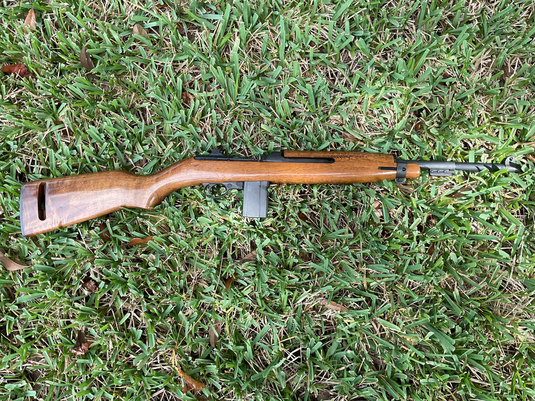

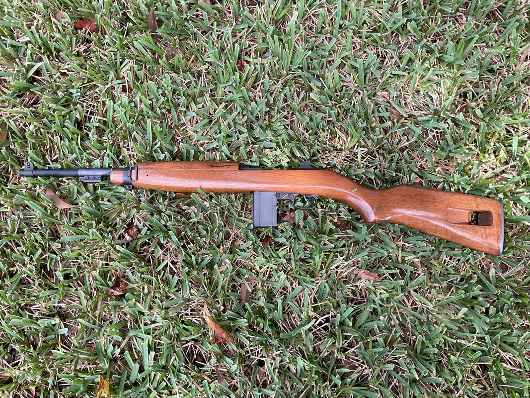

The gun came to me very blond and shiny. The original owner said it was tung oil, but I’m pretty sure it was some type of polyurethane.

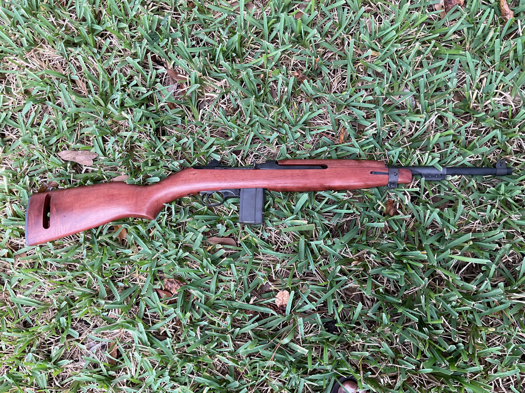

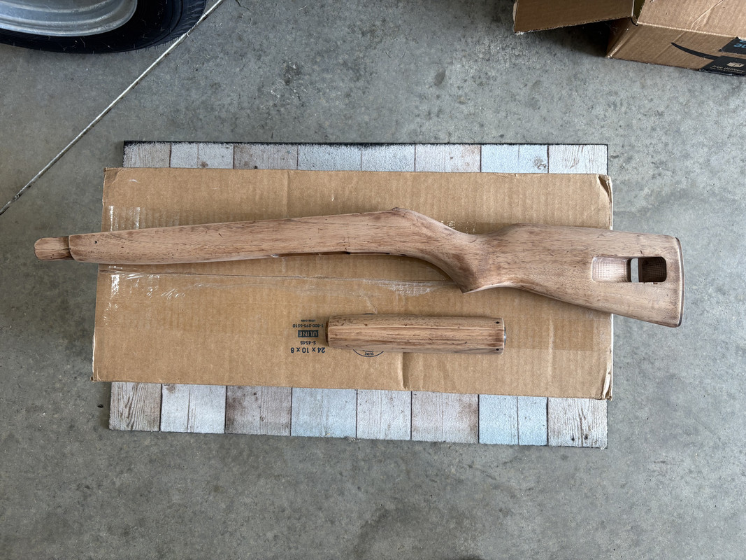

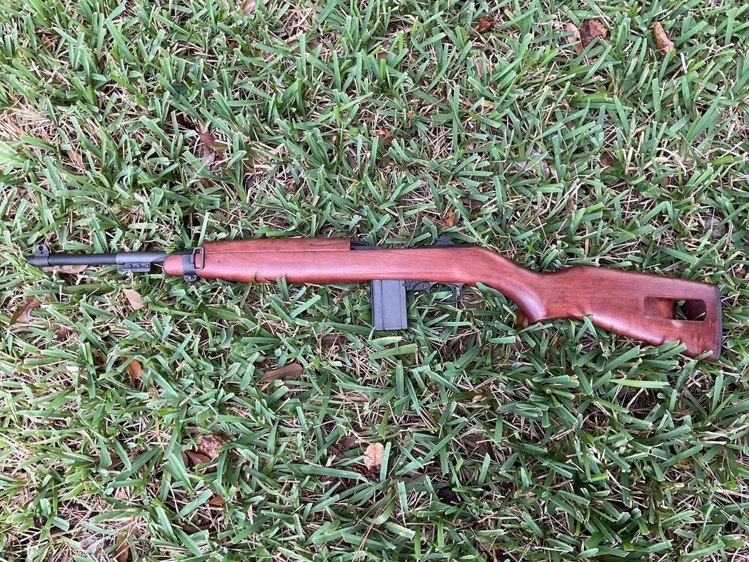

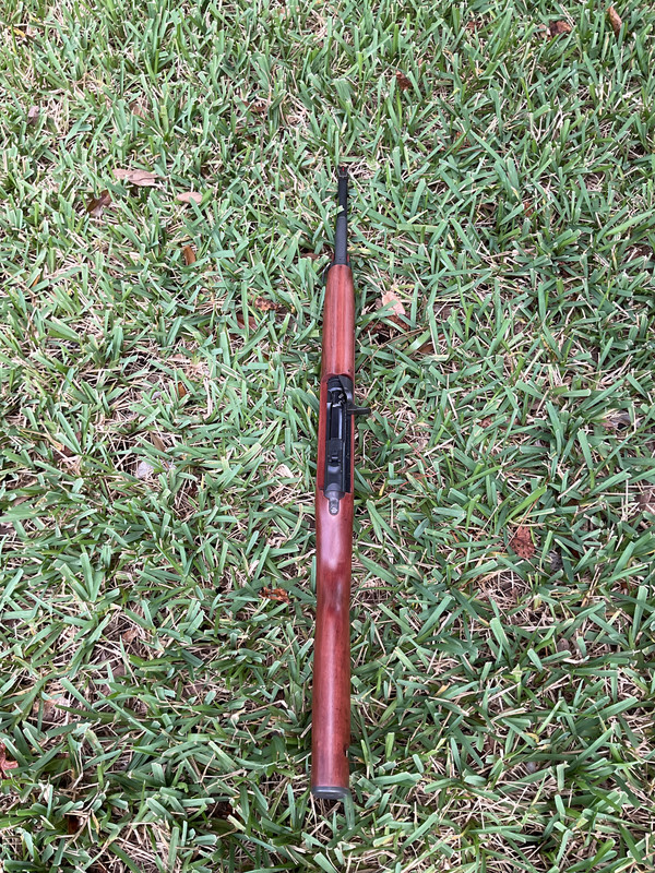

I sanded it down using 60, 80 and 150 grit paper and stained with a black cherry stain. She now looks like proper M1 Carbine.

Her she is before and after refinish. I’ll get more pics when the rail arrives.
She came out very nice and only took about 2.5 hours of work.

Great job on refinishing the wood.

The prior owner probably either put poly or varnish over top of tung oil, or else used a "tung oil finish" from the hardware store (Minwax/Watco/etc.) which is a bit of oil mixed with various petrochemicals.
Either way, nothing like the original pure oil finish used on USGI rifles.
While your stain refinish also isn't historically accurate, it at least looks closer to the appearance of aged oiled walnut, and is a marked improvement over how you received it. Good enough for a reproduction rifle.

Looks nice. In fairness I thought it looked really good prior to the refinish as well though. Even if it wasn’t the period correct finish.

That's nice work...I much prefer your refinish to the way you received it. I'm glad to hear it shoots well...I've considered picking one of those Auto Ordinance clones up, but haven't come across one cheap and I've heard mixed reviews.
