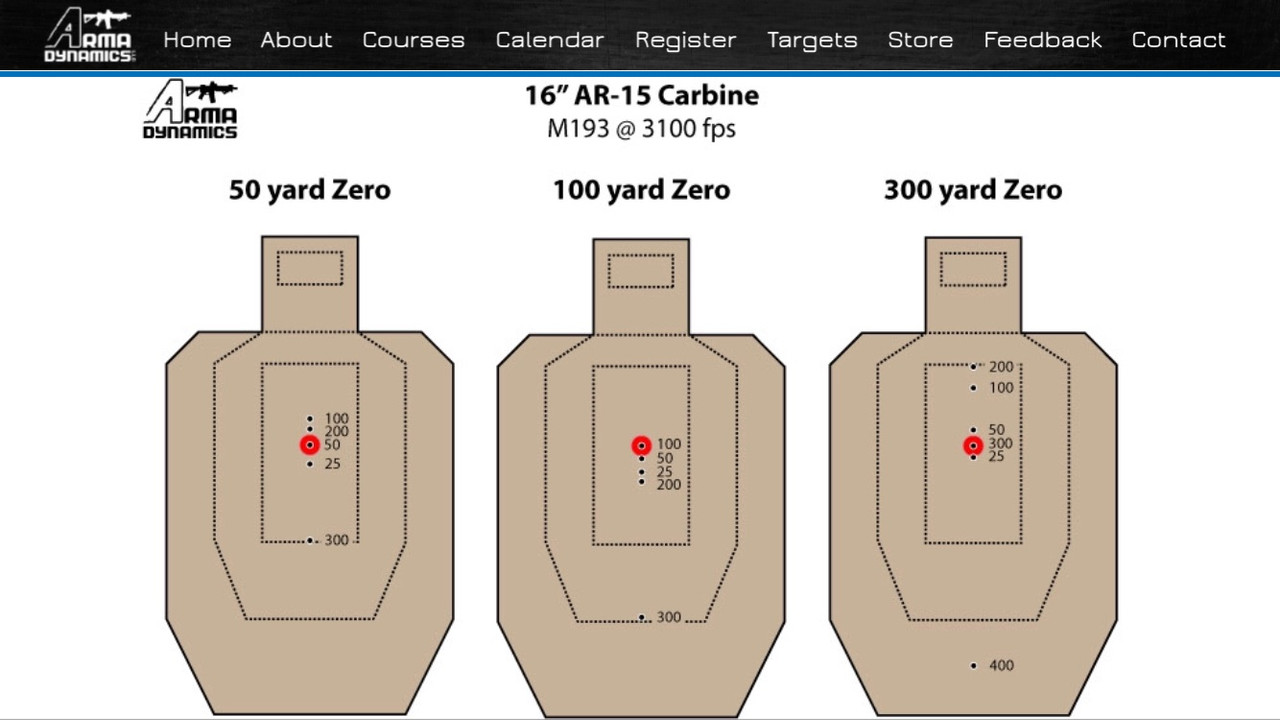

I’m in the camp of, if you have irons on it the red dot should co-witness.
No sights just a red dot……100 yds
But know that if you pop one off at ten yards it’s going to be about an 1 1/2” lower than the dot.
I used to train people and I took several targets and shot the AR15 at 10, 20, 30, 40, 50, 60, 70, 80, 90 & 100 yds. I had a helper go down range and mark each round after it was fired. Then we all looked at how far off the round was from the point of aim. This was so that if an officer had to shoot closer than the 100 yds the carbine was sighted in he would know how far below the point of aim the round actually impacted.
You should do that too!

I prefer a 50yrd zero on personal defense ARs with red dots.
100yrd zeros for the ones with scopes.
Of course you do have to shoot to prove the zeros vs just assuming your results will match an image. But mine have resulted in very nearly the same deviation.

Great graphic.
I too use the 50 yard zero. Recently, I shot 350 and held about a foot over the target (pepper popper). I scored 10/10 hits at that distance with that holdover.

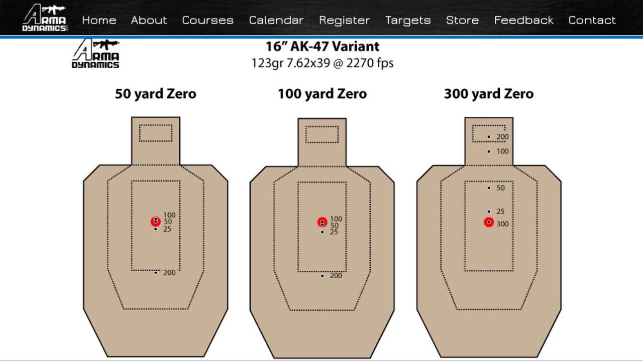

OP is asking about 300 BLK, so those holds would be different, of course.
Posts: 19893 | Location: SE PA | Registered: January 12, 2001Reply With QuoteReport This Post
Winner, winner, chicken dinner. At least one understands 300blk isn't 223 Remy.
Depending on the bullet weight they’re close to 7.62x39 but I’ve not looked to see if the company has something for 300blk.
Not really a vast difference with a 50yrd zero out to 150.
