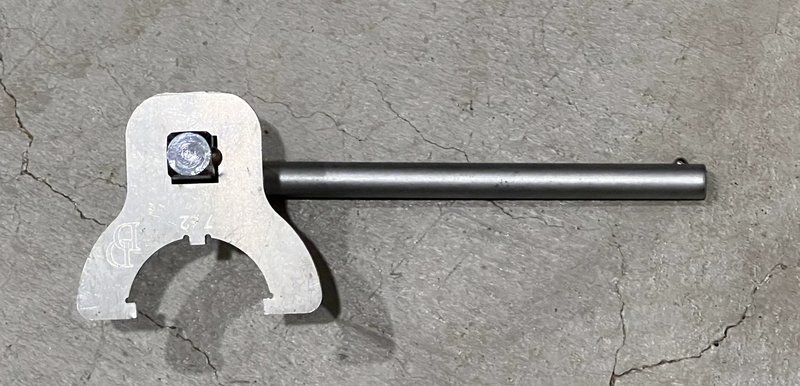

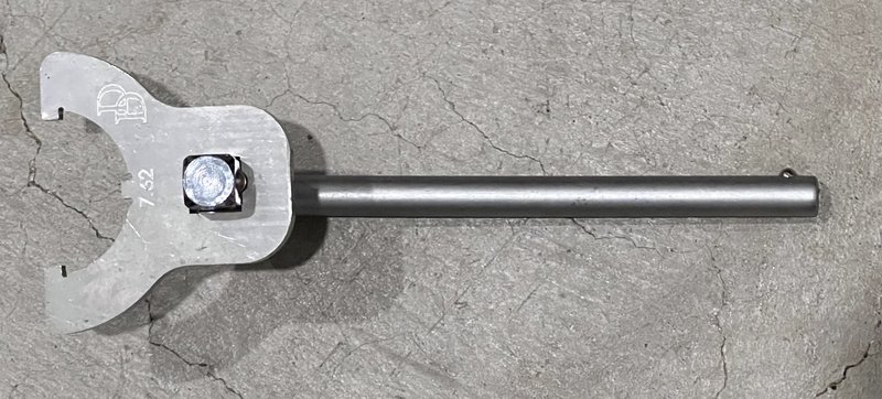

Attached to the nut wrench it's not the same length and the exact reading anymore. Exceeding 85 is dangerous as you could strip the aluminum threads on the nose.
If you use the torque wrench properly the torque value doesn’t change.
If you put a wrench attachment (outside the gun world, crowfoot wrenches for use with torque wrenches are common) on a torque wrench at right angles to the torque wrench - so the fastener is on the line through the square drive that is perpendicular to the handle - the torque applied to the fastener by the wrench attachment is the same as the torque applied to the wrench attachment by the torque wrench.
I didn’t want to dig up my torque wrench, so I used a sliding T-handle, but it’ll do for a demo.
Torque value is wrong:
Torque value is correct:
