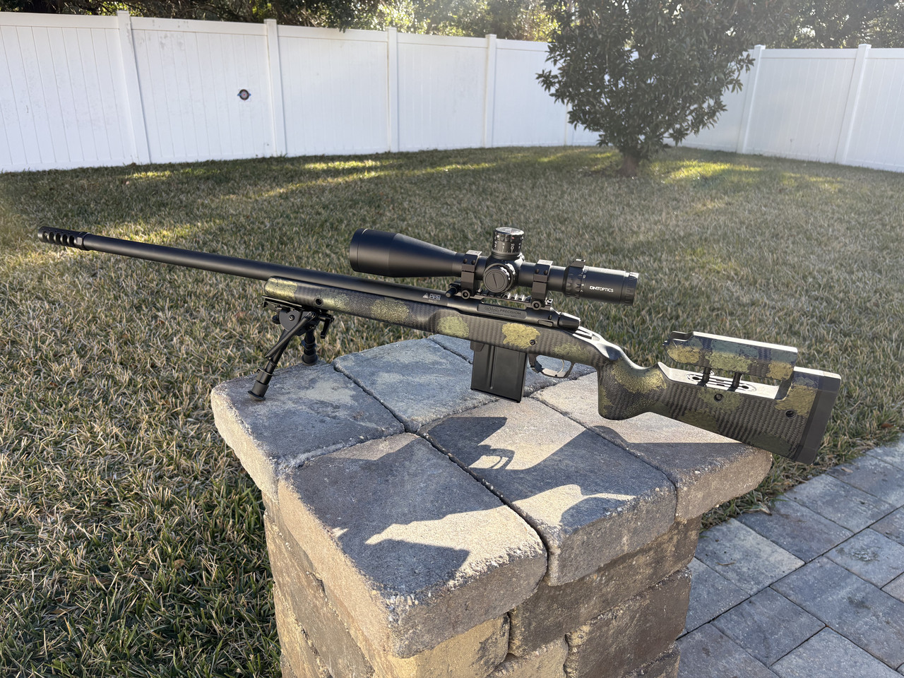

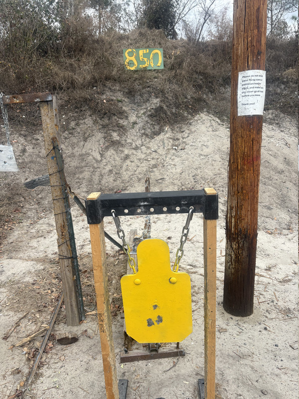

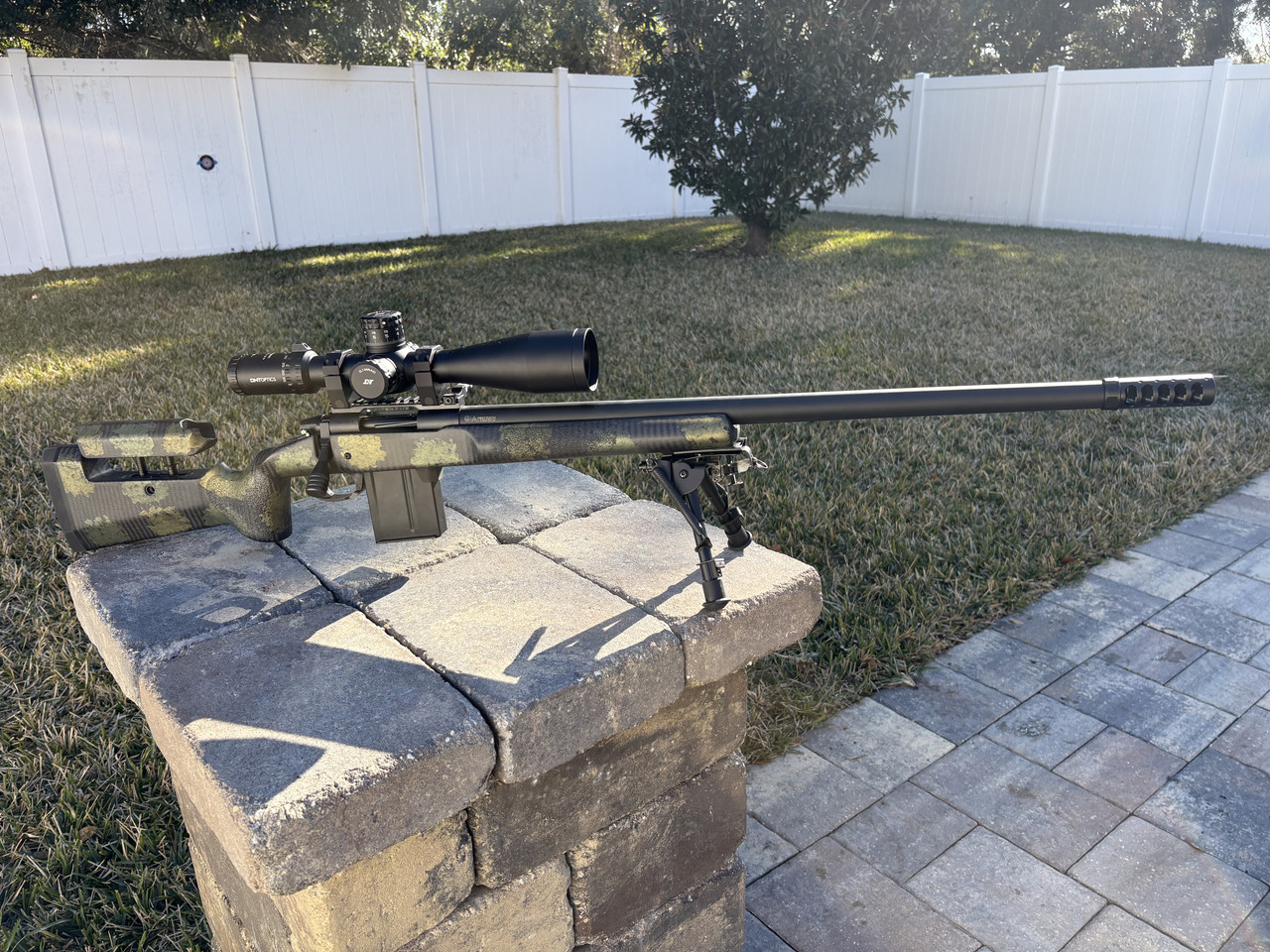

Take a hard look at DNT Optics “The One”. 7-35x56. Good clean Japanese glass. 34mm tube with plenty of adjustment to get you to 1k. I have the scope on my GAP 6GT and shoot with 4 other guys who have the same scope. We take them to 850 with 6GT, 6 ARK, 6 Grendel, 6.5 and 6mm Creedmoor and never go past one revolution. They are around $600 delivered which leaves plenty for nice rings and some ammo.
Google them and the many positive reviews.
As stated above, you do not need super high magnification to shoot to 1k. This group was shot on 15x. It is a 5 shot 3.5” group at 850yds with 6GT.

I looked that scope up after seeing it on your 6GT build thread. It gets very good reviews indeed.
