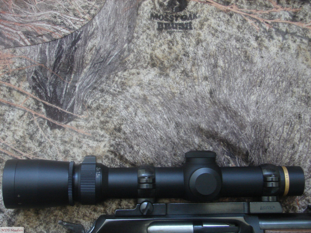

Leupold VX-III 1.5-5x20 Duplex Reticle, Leupold rings, Leupold base. I have a hammer extension mounted but not pictured.
I scored a new old stock mount and rings off GunBroker, link to another set below.
Might end up having to lap a bit but hopefully will match up with the bluing of the gun.
Anyone know anything about these?
