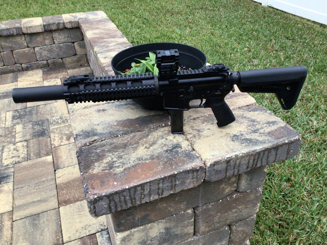

I run a Colt pattern SBR 9MM. This one is an integrally suppressed LRM M169. It uses a 6” ported barrel that allows 115gr ammo to be slowed enough to be subsonic by the time it leaves the suppressor. I have had this upper for many years and it is 100% reliable and quiet with full power ammo.
As a side note. Metalform makes the mags for Colt and you can get them for much cheaper than Colt marked mags. These used to be $19.99 from CDNN when the Colt mags were $60. I have 10-20-and 32rd mags.
