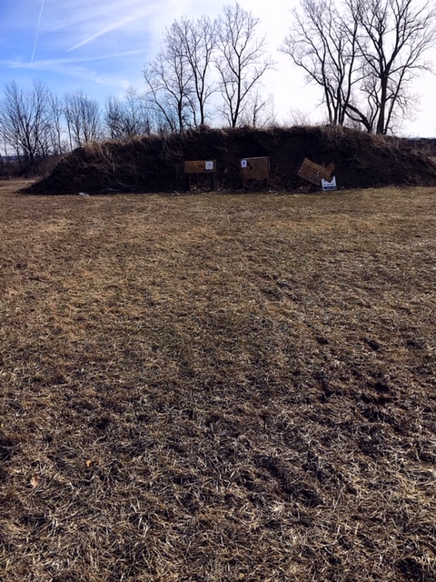

Set up at 25yrds
Ran cheap ammo looking for issues

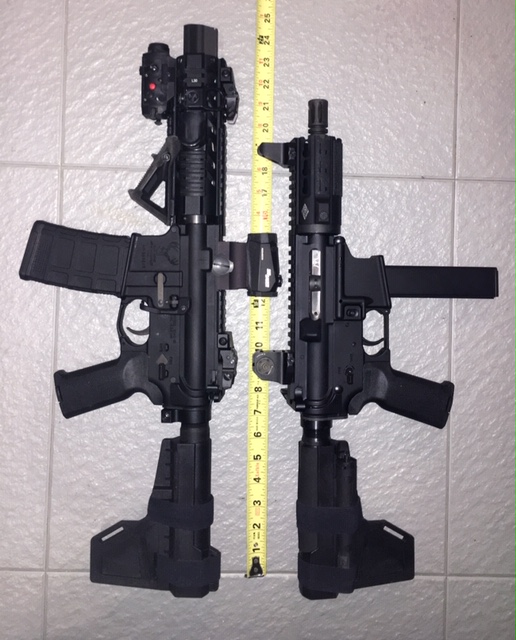

At 21” it makes my 7.5” 5.56 look fairly big
Makes a 16” look Huuuge.

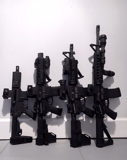

4.75”, 7.5”, 10.5” & 16”
