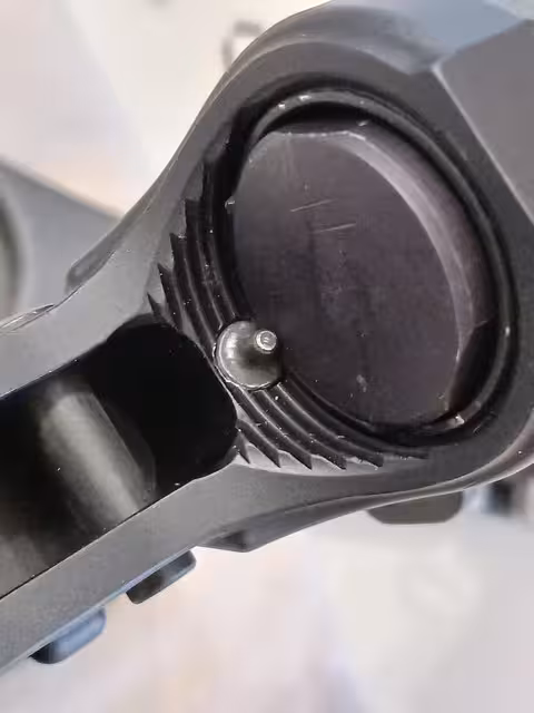

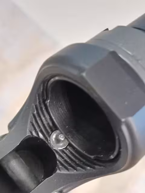

I did raid another parts kit for springs, and reassembled.
As Postimages isn’t working reliably lately, I’m working on finding somewhere else to host a pic.
Meanwhile, here are two pic links:
https://ibb.co/DD6xwc41
https://ibb.co/1J9QkGFr
Pics (if they work):
June 01, 2025, 06:55 PM
vthoky
Tinkering with it some more, things seem to be normal now. Maybe I simply didn’t have the buffer tube screwed in far enough on the first round.
