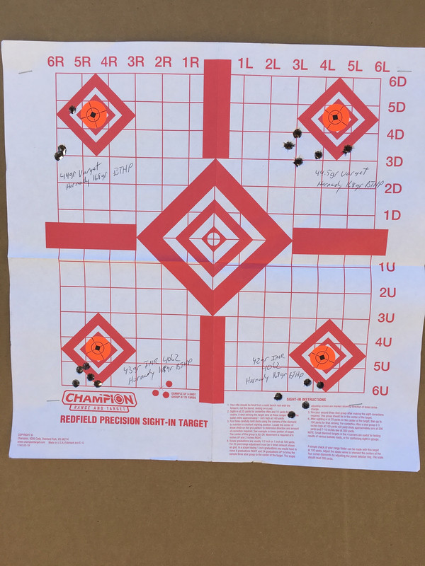

Hello guys,
I loaded my first 308 ammo a few days ago and was able to test them yesterday. The gun is a LMT MWS with 3.5 power Trijicon TA11 with 308 BDC.
Loads were:
Hornady 168gr BTHP
44gr Varget
Win LRP
Win Brass Trimmed 2.005
OAL 2.79 - 2.80
Hornady 168gr BTHP
44.5gr Varget
Win LRP
OAL 2.79 - 2.80
Hornady 168gr BTHP
42gr IMR 4064
Win LRP
OAL 2.79 - 2.80
Hornady 168gr BTHP
43gr IMR 4064
Win LRP
OAL 2.79 - 2.80
Shot #1 was from a cold barrel. I should have used it as a fouling shot as the next 4 shots using the 44gr of Varget went into the same hole. Not bad at all from a 3.5x optic. That will be my new load. The 43gr of 4064 did very good as well. To be honest, a higher power optic and getting around to changing out the factory trigger with my Larue MBT will have all those groups at MOA.
I am insanely impressed with the 44gr Varget load.
**I wrote IMR 4062 on the paper, but used 4064**
All groups were 5 shots at 100 meters.
Factory ammo for comparison: 168gr Federal Gold Medal SMK.
