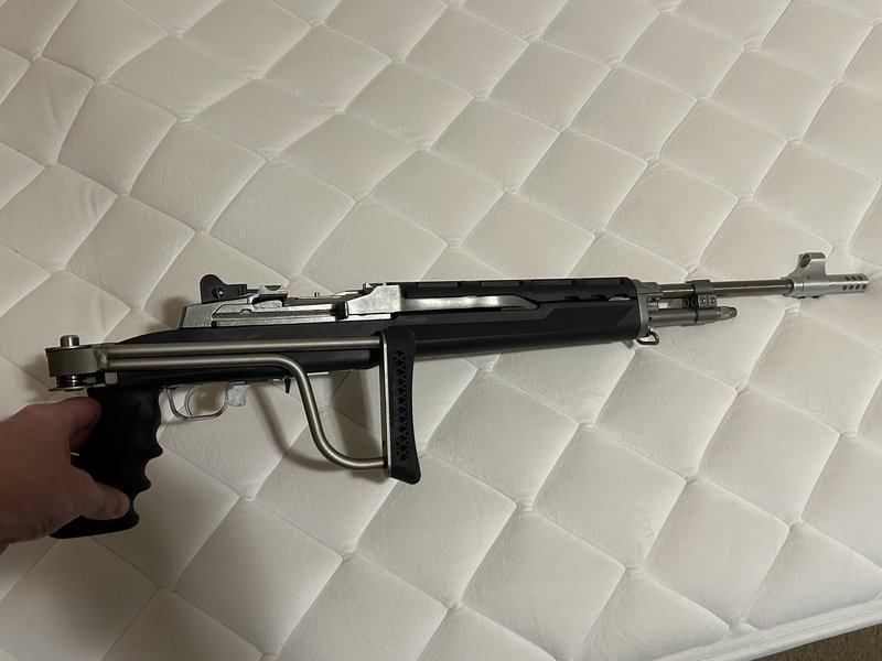

7 Aug: Completely disassembled, cleaned, scrubbed, and reassembled with proper lubrication. I was able to turn the ban era Butler Creek stock in a folding stock from the welded fixed position. Added a new rear sight, handguard, brake / front sight combo, and accustrut. Still need to drill the gas block for the set screws and fix the gap between the handguard and stock. Otherwise its all ready to test when I got back down in September.
Best of all, once I finished it, he said, "keep it". So I'm gonna trade him an extra AR I have for it instead.
ETA: Seeing I need to tighten the set screws on the brake also.
I brought it home, rated for .223 and it had a steady diet of 90 round drum mags of 5.56 tracer so I gotta break it down and figure out what is broken.
I’m thinking slide spring, gas piston, or something with the sear. Good news is barrel looks okay. So as long as the receiver is okay I should be able to fix and load him some .223 level rounds for future use.
More to come once I get off next and can inspect the cleaned parts.

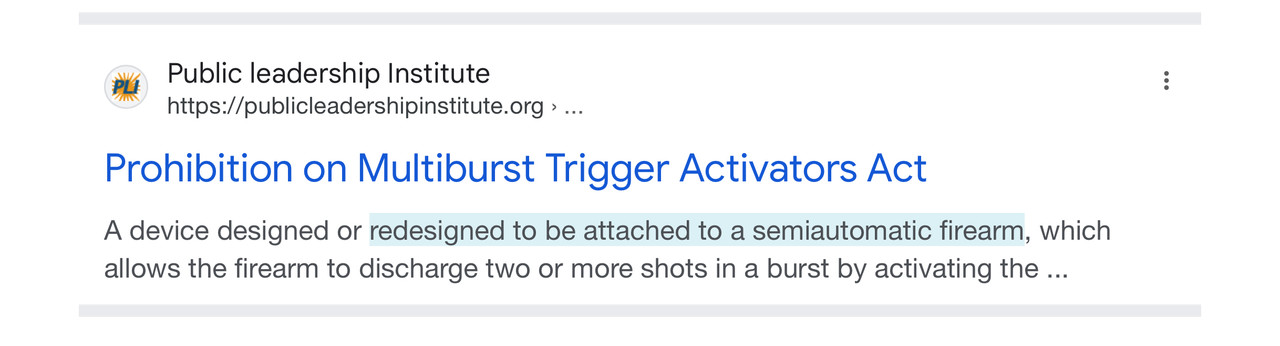

I was pretty sure I knew what the activator was (at least the crank type) but I Googled it anyway ant it turns out there are several, including the bump or slide stock. Then I saw this:

Got it all broken down, cleaned up, and went to town with steel wool.
I can’t find a single thing wrong, other than…does the gas pipe normally have a tiny amount of play on mini-14s?
I don’t own any me to compare but if so I’ll buy a new one when I’m buying sights.
Not sure if you received my email, Ottosig (things are crazy as I migrate to a new laptop) but it's normal. A certain amount of play is necessary so the cylinder and piston can come together smoothly.

So why was it malfunctioning? What was broken/wrong with it?
Posts: 10934 | Location: New Hampshire | Registered: October 29, 2011Reply With QuoteReport This Post
Picture of OttoSig
Couldn’t find anything wrong. There was quite a bit of gunk, the consistency of sorghum, built up on most parts internally. He claimed that was from sitting for 10 years but it’s the only thing I can think of. I’ll test it next time I got down and go from there, but I’m pretty confident it’ll function just fine.

Picture of kkina
^^That's quite a common occurence for Minis that have been settin' around a while. Sometimes the bolt gets competely frozen (easy to free up, though).

Picture of OttoSig
She’s slicker than owl shit now, Sir. And thank you for all your help. Couldn’t resist grabbing one of your accu-struts after we spoke!
