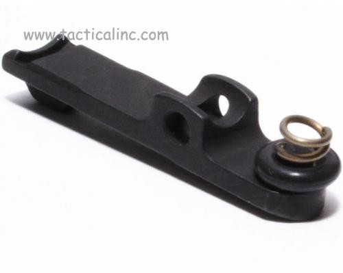

I had an aero AR-10 that did the exact same thing. Found out that someone put two orings around the extractor spring. This was making the extractor too strong to latch on rim of the cartridge.

I took the bolt apart and there were two O rings. I removed one of them and reassembled the bolt carrier group. I put a .308 cartridge into the chamber and allowed the BCG to go forward and it closed fully and locked. I will return to the range next week and see if that fixed the problem...

Many manufacturers and private builders will install an O-ring on their AR extractors, under the rear of the extractor and around the extractor spring. This adds extra tension to the extractor. This helps compensate for overgassed guns, to prevent the extractor from slipping off the rim during cycling and causing a FTE. It also adds extra insurance against weakening extractors from the extractor springs wearing out and causing similar FTE issues.
In this case, it appears Aero may occasionally be adding two O-rings, which overly tensions the extractor and prevents it from being able to slip over the case rim during feeding, thus preventing the OP's bolt from fully closing.
One O-ring is fine, but two is too many.
I suspect, having removed the second one, that OP's rifle will work fine now.

I think Aero AR10s come with 2 O-rings on the extractor spring. Some think it contributes to more damage to the brass. I hadn't heard Aero does this to compensate for overgassing.

This was related to extraction problems, but it sheds light on the double O-ring setup and some extractor tuning suggestions. A response from Aero:
"Good Morning Zeke,
Thank you for reaching out to us today.
Thankfully the fix for this should be very simple, as it looks like your extractor is exerting to much pressure on the brass, so the ejector isn't able to kick them out
If you remove the extractor, you'll see the main extractor spring, with a smaller spring in the center and two black rubber o-rings around it.
The o-rings are there for tuning your extractor for different types of loads. Go ahead and remove either or two o-rings. I'd start with one to see if the issue is solved, but if improves but not completely solved, remove the second one as well. You can dispose of the small center spring as well.
This will lessen the extractor pressure and allow it to actually let go of the brass.
Rest assured, this problem is completely normal and should be solved by the simple steps above."
