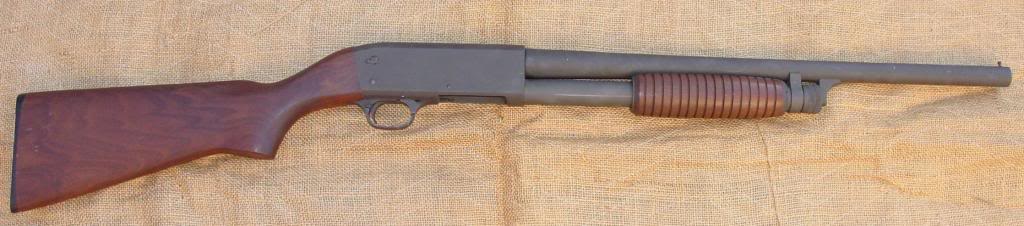

Picture of jhe888
I have an old Ithaca, so I could do it like Herb Parsons. I don't know how fast though.
