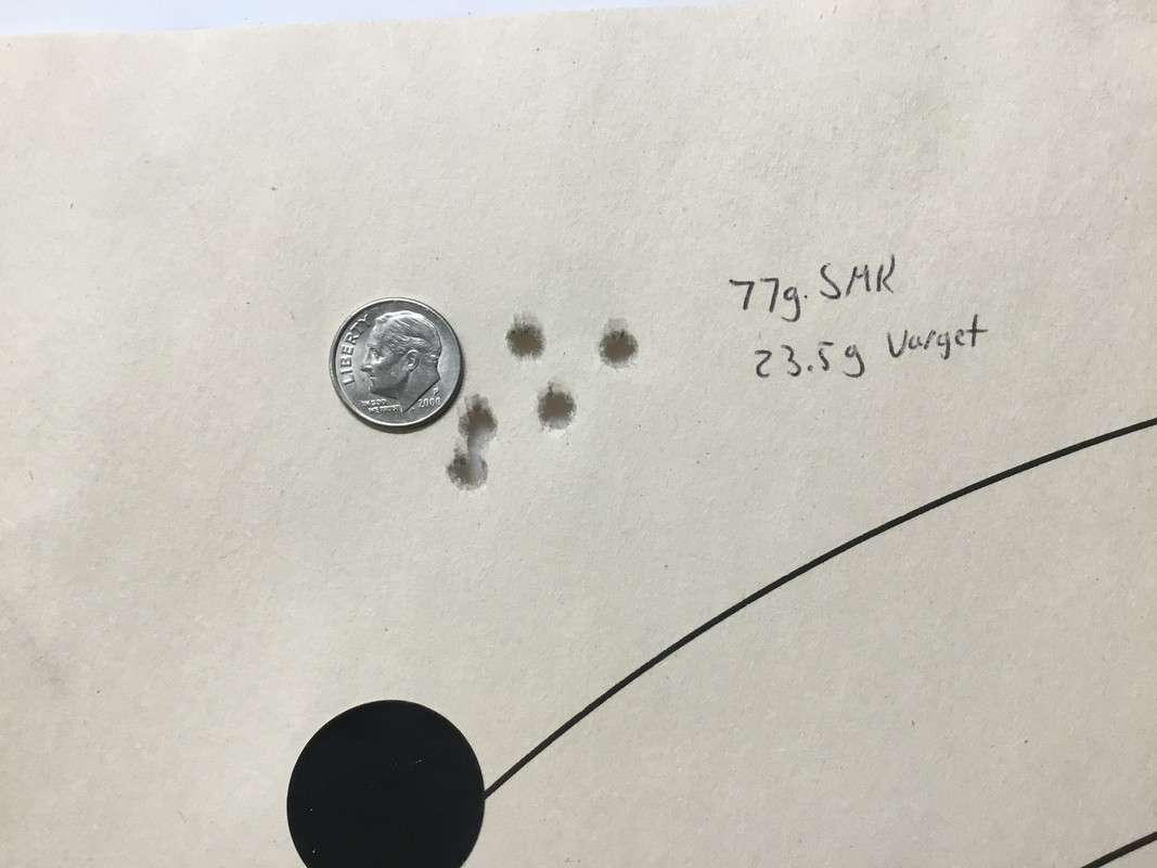

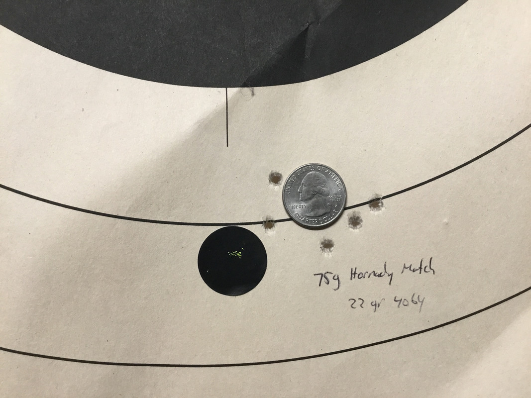

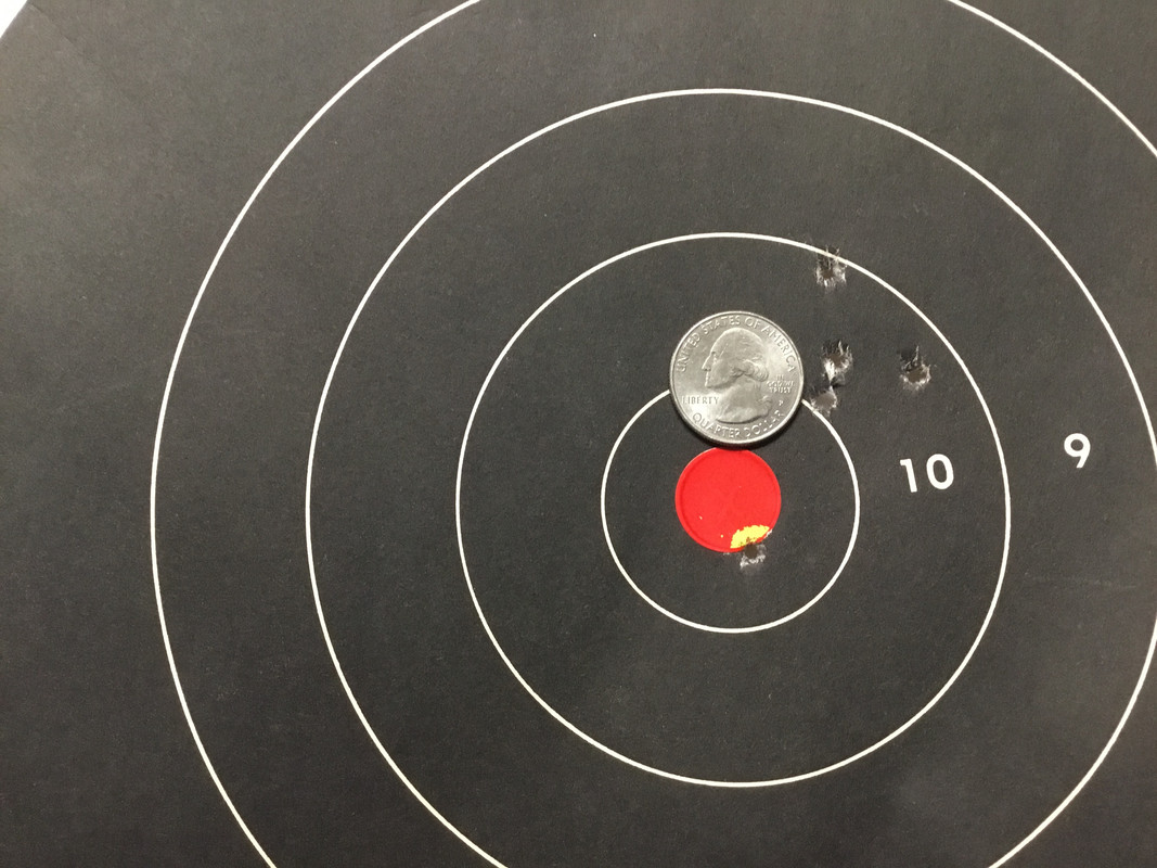

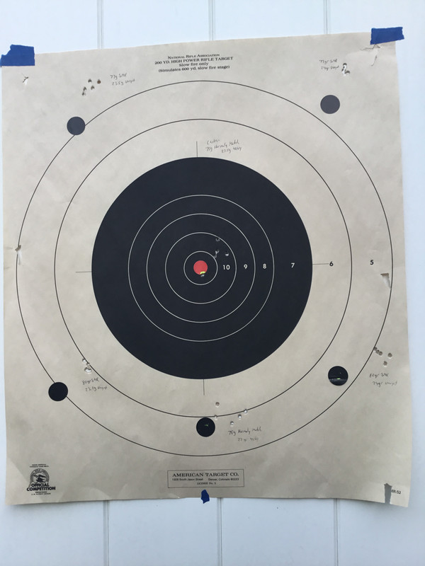

This morning I loaded up some 75gr Hornady Match, 77gr SMK, and 80gr SMK. This gun shoots 55gr Vmax and 69gr SMK like a laser, but hates anything 75gr. The 77gr loads were sweet as well as the 80gr. As you can see, it did not like the 75’s. I had already shot it with 75’s and Varget, so I tried the 75’s with 4064. Same results. All groups were 5 shots at 100 yards using a 10x SWFA S/S.
Loads were:
Hornady 75gr Match
22gr IMR 4064
2.26 OAL
Hornady 75gr Match
22.5 gr IMR 4064
2.26 OAL
77gr SMK
23.5gr Varget
2.26 OAL

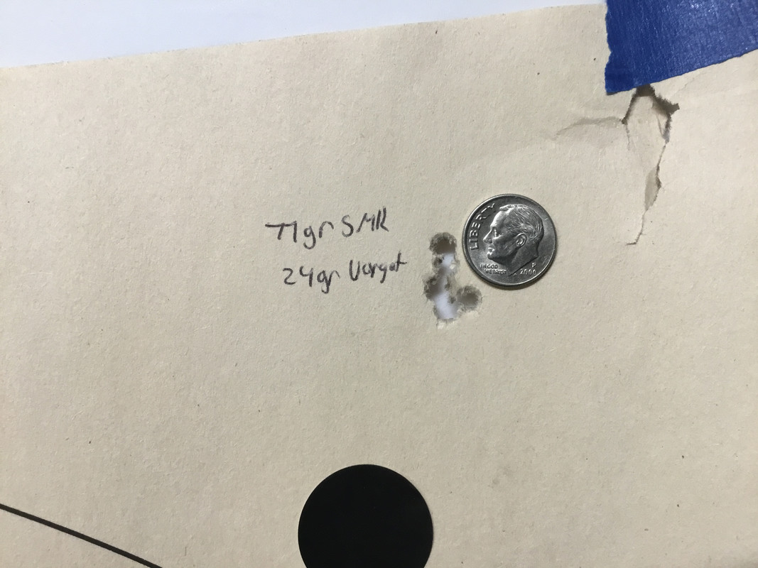

77gr SMK
24gr Varget.......Most accurate.
2.26 OAL
80gr SMK
23.5gr Varget.........2nd most accurate.
2.55 OAL

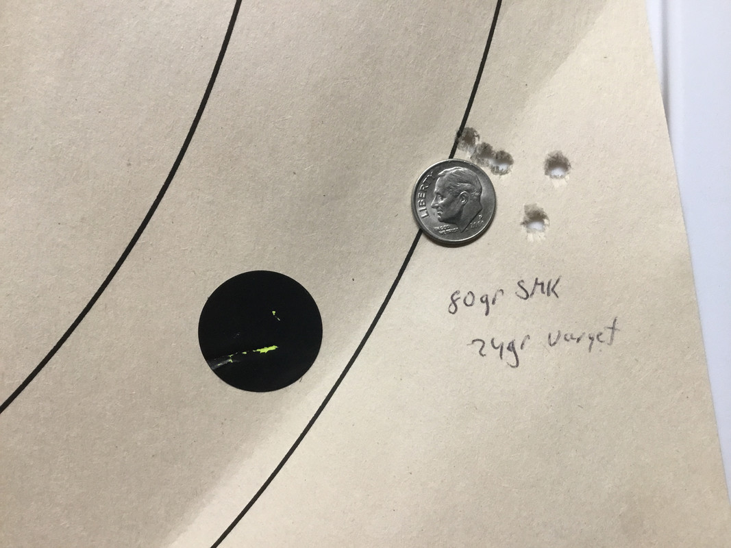

80Gr SMK
24gr Varget
2.55 OAL

This is a bold statement. You’re basically saying all bolt guns with an optic should shoot every type of ammo into less than 1” groups or something is wrong. I’m willing to bet there are millions of bolt guns that will not shoot MOA even with an optic if it does not like a particular ammo or bullet weight. Find what it likes and all that changes. Here are the same groups from that target so that you can see it in detail. With ammo the gun liked, it was shooting sub moa. With ammo it didn’t like, the groups were larger. My optic is a fixed 10x tactical optic and not a target scope so a finer reticle would definitely help. This particular gun just does not like 75gr. I the shooter am capable as is my gun and optic with the right ammo.
