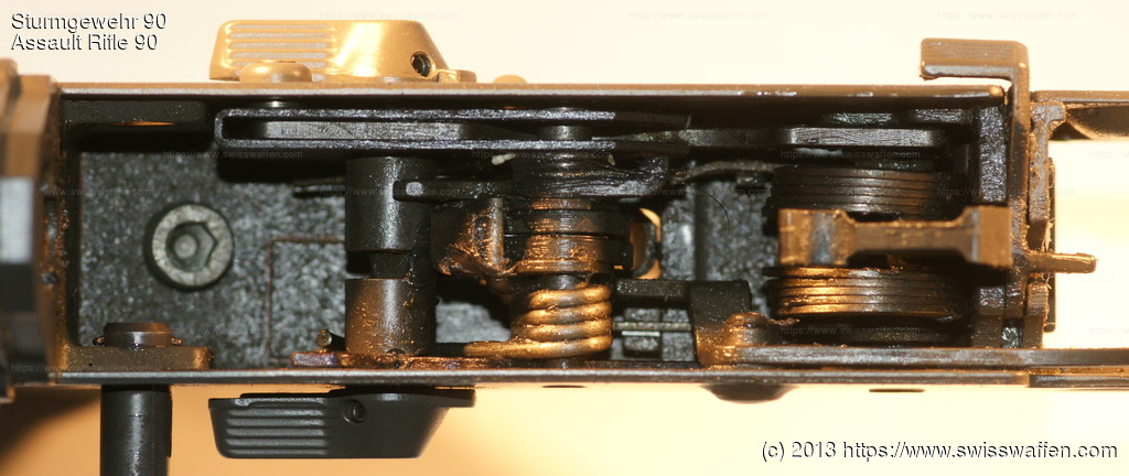

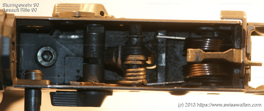

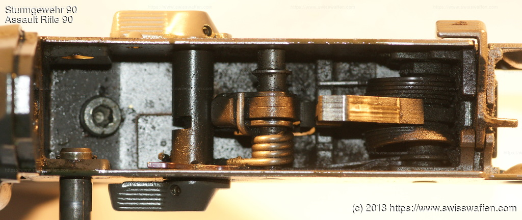

Picture of MG34_Dan
Look what I just found on the inter-web.
Originally posted by bigbofo:
I can't feel any trigger difference between the PE90, the 550-1 and an original army version Stgw 90.
Here a PE 90:
Here a 550-1, which is the same as an army Stgw 90:
And here an army version which has been converted to semi-auto:
This is exactly what I was looking for. Now all I need are the specifics of the components.
