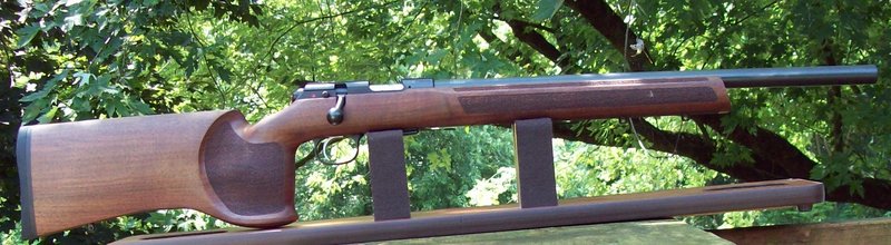

Was shooting factory class with a Ruger precision and not doing well. Low and behold, after clamping the gun in a vice, instead of all the errors being ammo or me, turns out the gun was just shooting the best it could. So... out with the old, in with the new.

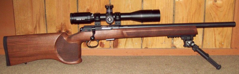

Fresh out of the box. She'll be getting:
- SWFA 20 x 42 SS Gen 2
- Hawke 11mm dovetail/30mm tube rings
- AREA 419 Improved Bi-pod rail
- AREA 419 Bolt Knob
- ATLAS® BT10-LW17 V8 Bipod
That's it unless shooting dictates something else. To be continued.....

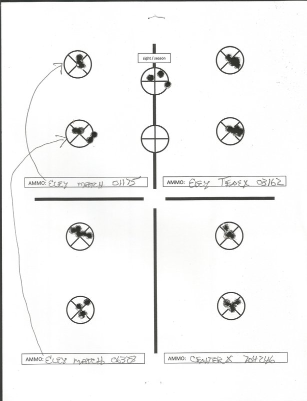

Well, rifle is almost done again. I need to get the scope down a little. Lost the sight picture a few times so I didn't bother shooting any targets.
Anyway, once I get it set up, I'll shoot some match targets. Until then, it's pretty obvious she'll be accurate enough for competition. And, I'll have a few different ammos to choose from. I screwed up and grabbed from the wrong box in the upper left, but results are pretty apparent. (circles are 0.75")

I didn't even bother to bring the SK test target home. Best group was .78" @ 50 yds. The 4 others I shot were almost an inch. This rifle pukes on SK. Looks like Eley Match or Tenex @ about 1060 fps is its diet.
