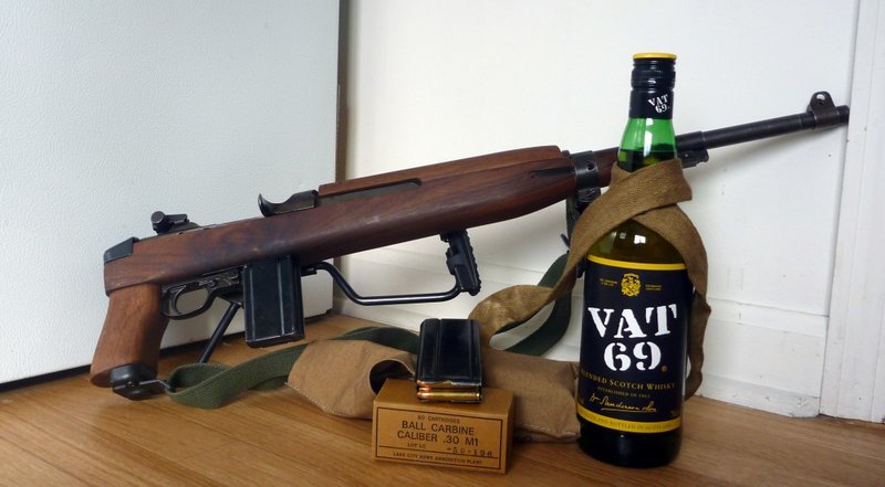

I picked this up at Tulsa about 10 years ago. The rifle and those accessories were a package and he wanted $800...we ended up agreeing on $700 for everything. IDK, I might have paid too much but it was something I just had to have. The rifle is an Inland with serial number of 5121284. I was told it is tough to figure out a build date even with a serial number but what do I know? The reason I am providing all of this info is just because the first thing I want to know is, well... what did ya pay for it?
Here is my problem. This thing has always failed to eject a spent case every four or five rounds. The case always gets held up between the magazine and chamber. I've used various brands of magazines (a few came with the purchase) and some the ancient mags are the most reliable. I just recently bought three KCI mags and the problem remained. The ammo varies from reloads to old factory stuff. I did some research and it seems like the Operating Slide Spring can cause this problem. What do you guys think? That slide spring is tough to find but I did find one place that still has it. An entire spring kit is non-existant right now. Or, am I going down the wrong road?
The bayonet fits perfectly:
I had to throw this in. Smile

Serial 5121284 would put it at early 1944. Check on the top of the barrel about an inch behind the front sight for a date, which will generally be roughly near when the carbine was finally assembled (but can be off by as much as a month or two), provided it still has its original barrel.
Wolff offers good quality M1 Carbine replacement springs. Or you can still find NOS USGI recoil springs out there on the secondary market.

When was the last time the bolt was disassembled, cleaned and inspected?
If you don't know, I'd be looking to buy or borrow a bolt tool for some cleaning and inspection.
Ejectors can get gummed up and extractors can chip and extractor springs can break.
Replacement extractors and springs are cheap and easy to find. Or at least they were pre-Covid. NOS GI is still out there. I think there was a fellow on both the CMP forum and AR15.com selling NOS operating slide springs as well as other carbine springs.
Bolt tool: https://forums.thecmp.org/showthread.php?t=270984
Operating slide and ejector springs: https://forums.thecmp.org/showthread.php?t=262915

I've used the Garand op rod springs from Orion. Solved a few issues. They also sell parts for the carbine.
They have a "rebuild kit" for $115 that has:
Firing pin.
Ejector assembly.
Extractor.
Extractor spring & plunger.
Op spring.
Trigger spring.
Sear spring.
Hammer spring.
Bolt stop spring.
Trigger pin.
Mag catch spring & plunger.
Double end plunger.
Hammer Pin.
Orion M1 Carbine Parts

Thanks guys for the replies. I looked just below the front sight and it reads: Inland Manufacturing--General Motors-- 3 44. So it looks like the barrel might be original with a build date of March, 1944.
I have never taken the bolt apart, just cleaned it. I will check out Orion as well.

The Wolff spring kit is well worth it...
Posts: 2485 | Location: Florida | Registered: March 01, 2012Reply With QuoteReport This Post
I had the same problem with mine, failure to eject.
I disassembled the bolt, cleaned it up, put new extractor/ejector springs in, now it runs great. I changed out the recoil spring too.

Bass, I think I've got a spare Wolf complete spring set. Hit up the email in my profile if you want and I'd be happy to send it to you on the next USPS wagon headed south.
