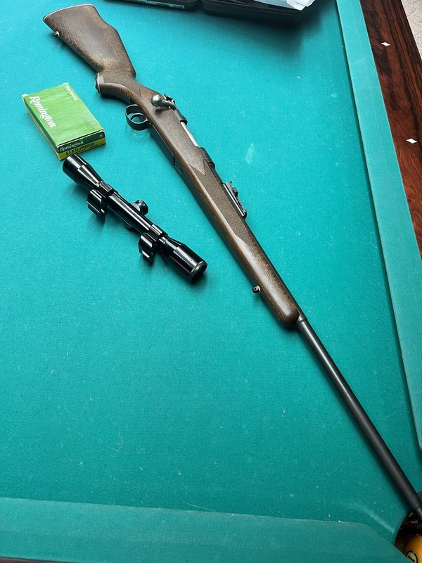

Picked it up cheap out of local trader

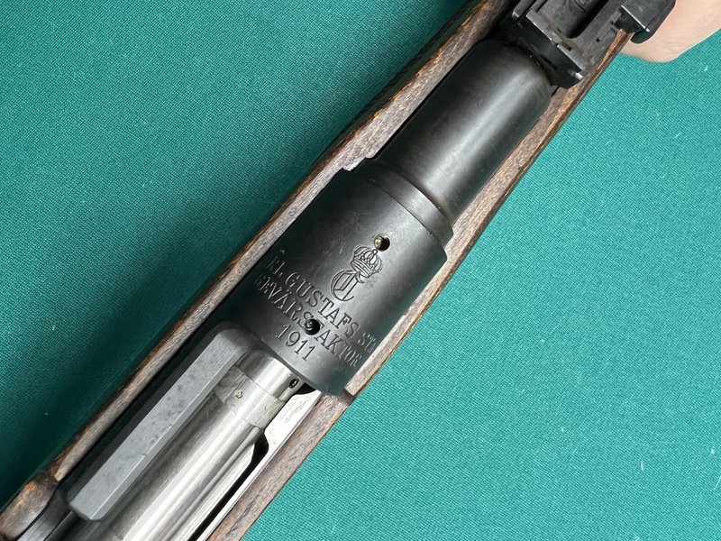

I’m going to say 96/38 that was simply put in a sporter stock
Metal looks good, reblued
No stamps or marks like it was converted by a gunsmith/company
Mix/match on receiver/bolt and bottom metal

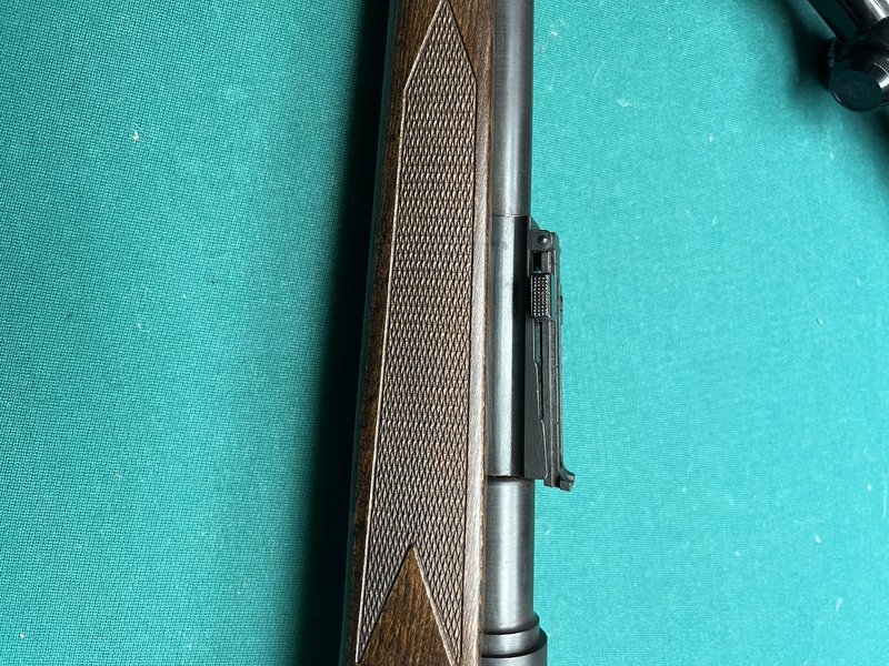

24-25” ish barrel
Sights look original to me

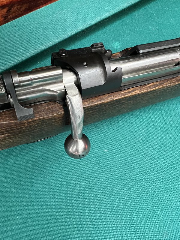

Would the bolt have been bent when it was converted to the carbine ?
It will clear the scope with the tall see through rings, just barely
No, the 96/38 conversions with original bolts have straight bolt handles. Their numbers would also match the receiver. Some may have had their original bolts swapped with a replacement m38 bent bolt during refurbishment if there was something wrong with the original bolt, but those arsenal replacement bolts would been number matched to the rifle. And they would have been used new manufactured bent bolts, not straight bolts that were later bent down.
Your bolt has clearly been modified.
Here are some original bent bolts from m38s:

The bolt does not look original, but the barrel does look like the front sight and the end are original. SO, I don't know.

It’s a Gevar 96/38. The bolt was cut and welded when it was sporterized. A lot of them got the treatment when they were cheap and plentiful because they made real nice hunting rifles at a very reasonable cost.

I’ve read where Kimber did a bunch of these, would they have been stamped somewhere ?
Or likely a local smith somewhere did it ?

The factory safety has been traded out for an aftermarket one as well.

Kimber stamped “Kimber” on the ones they did and used Ramline stocks.
Posts: 7016 | Location: Maui | Registered: December 15, 1999Reply With QuoteReport This Post
I'm searching my memory banks; perhaps 25 years ago, I want to say that several of the big importers offered sporterized Swedish Mausers. Century Arms, Springfield Sporters, etc. Recall seeing a scattered few at shows. As P210 has mentioned, I believe that they also used Ramline stocks in addition to bending bolt handles, and tapping the receiver. This was not done to their better grade rifles though. Does the barrel have any import marks?

No import marks I can see
Probably a decent job by an unknown gunsmith it seems

Doesn’t really look reblued but hard to tell for sure from photo. Import mark would likely be on barrel like in this photo on an auction site. Century marked theirs CAI ST. ALB VT

New barrels too. Not sure on one's in original. 6.5

I think the 6.5mm used the original barrel and the .308 and .22/250 versions got new ones.
I’m waiting to hear how it shoots once ElKabong gets a chance to see what it will do.

Definitely 6.5, came with some ammo actually
As soon as the weather warms up I háve several winter time purchases that need to be shot
