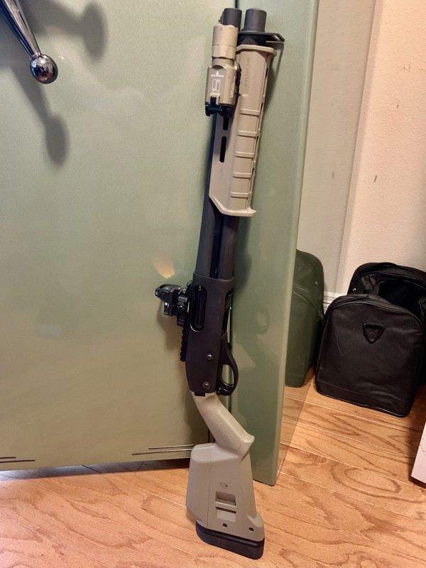

Police magnums are a good bit “heavier” duty, but like you said… if it’s not going to be abused you’d likely never wear it out. I picked up a lightly used LEO, 870 Police Magnum and SBS’d it. I’d like to get a Vang Comp treated barrel for it sometime.
