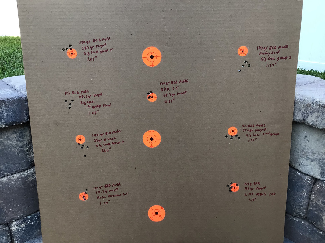

Today was hot and muggy, but any day on the range is a good day. I had the opportunity to shoot my new Sig Cross, RPR, AERO Precision all in 6.5 and my LMT MWS in 308. The loads were as follows:
120gr ELD Match, 38.3gr Varget, Benchrest LRP, 2.67 OAL
123gr ELD Match, 38.3gr Varget, Benchrest LRP 2.67 OAL
140gr ELD Match, 38gr H4350, Benchrest LRP, 2.82 OAL
147gr ELD Match factory load
175gr SMK, 42gr Varget, Benchrest LRP, 2.80 OAL
All groups are 5 shots with the exception of the first group and the 308 group. The Sig seemed to do well with all the loads. The limiting factor was the reticle which covered the small 1” targets. The gun seemed to like the lighter grain bullets the most and will make a great lightweight hunting rifle. As a matter of fact, the very first shot out of the gun at 25yds was dead center. You can’t do better than that as far as a backyard bore sight goes. I fired the last 4 at 100yds and zeroed from there.
The RPR was a tack driver with the 120gr, shooting a .89” group. The AP was pretty close with the 120gr, but I threw one.
My LMT is just a joy to shoot. That is 7 shots at a pretty rapid pace. I see why it is used by several armies around the world.
I will be pushing these guns out to 200 and then to 800 in a few weeks. I think the 120gr load will be my most used load.

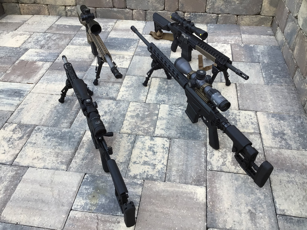

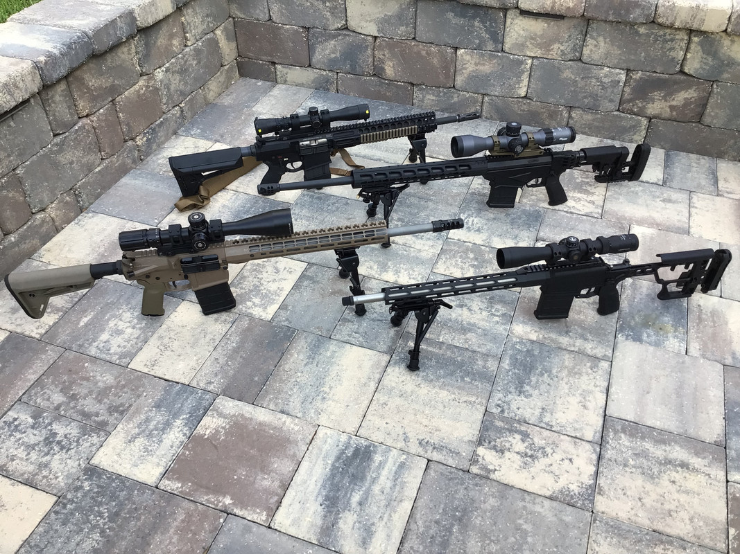

The guns in question.

How did you arrive at those recipes?
or are they just a calculated starting point?
Love your assortment of weapons.
Thank you Sir. I have been working up loads and these are the ones showing the most promise. I used Hodgdon middle of the road loads and worked up.
