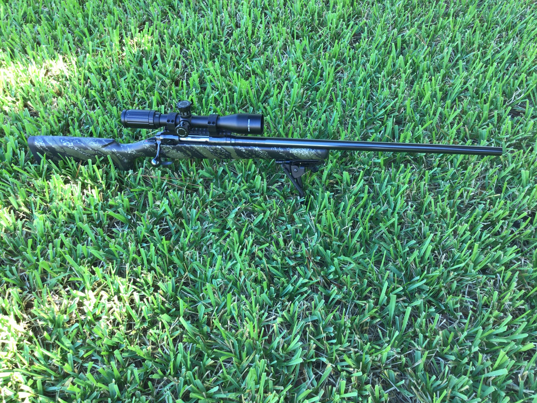

I love the gun, the accuracy, and no sore shoulders. My 6.5 and 308 will be in the safe for a while.
PS. I replaced the Choate Plaster stock with e BC Duramaxx….mo better.
