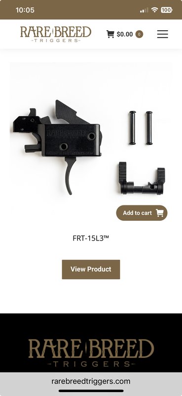

For those interested, Rare Breed FRT 15-L3 triggers are back in stock
https://rarebreedtriggers.com/...t-category/triggers/
