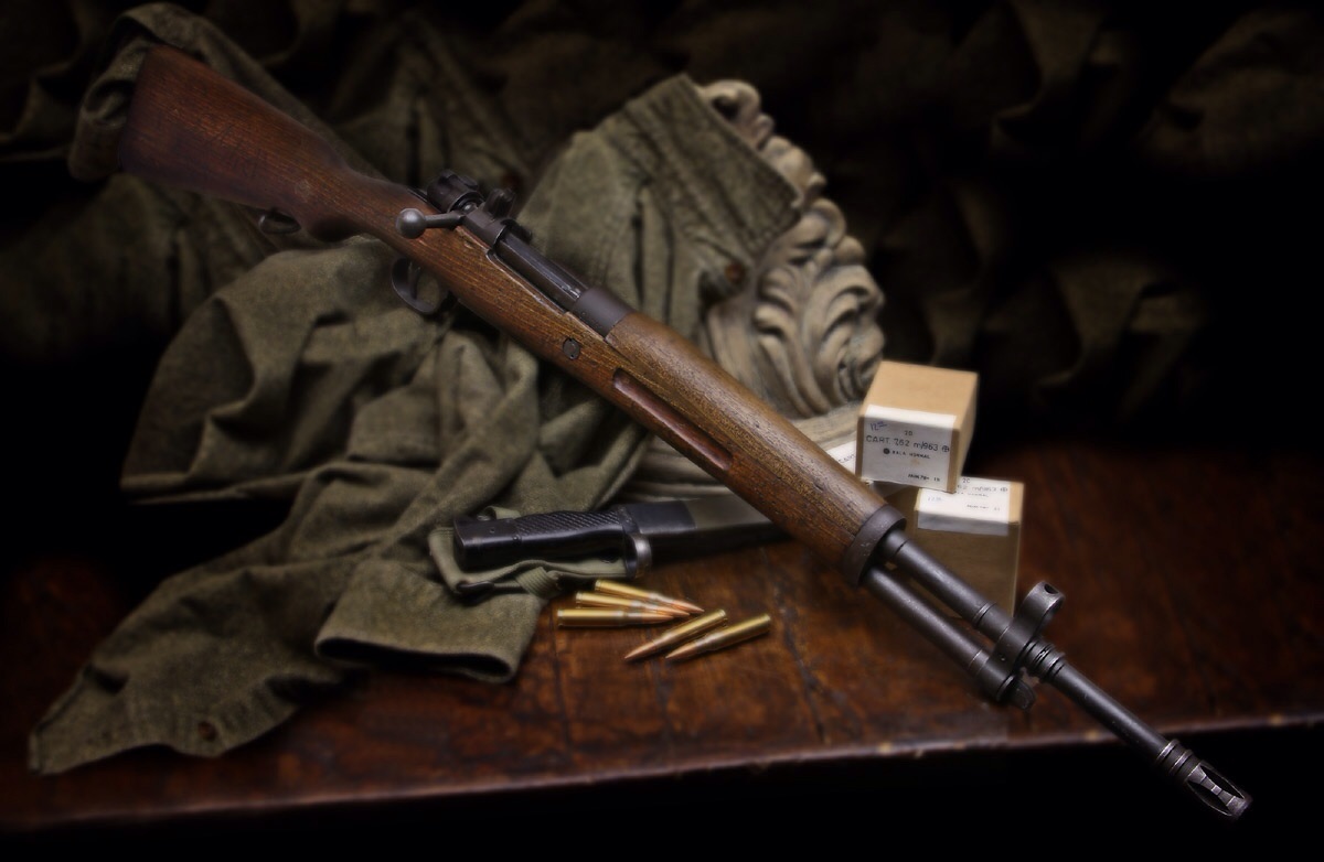

What experience does the forum have with the Spanish FR8?
I tried asking about these on a local forum and didn't get much feedback, so I thought maybe the Sigforum brain trust might have more experience. These have been on my radar for a while, and the idea of a handy little bolt action in 7.62 Nato has a lot of appeal. My recent trip to Spain (specifically Oviedo, where some of these were rebuilt) has me even more interested in picking one up.
I've watched all the youtube videos I could find, and know most of the background info, but what I'm curious about is what are people's real life experiences actually shooting these things? Are they reliable? Accurate? How smooth is the bolt? Are they fun to shoot or do you feel like you're fighting the rifle all the time trying to get it to run? Will it hold a decent group or will it be like my ex-mini-14 that struggled to keep 5 rounds on a paper plate at 50 yards?
If I get one It'll be to shoot it, and I'd like for it to be at least moderately practical, not just a safe queen or momento. I realize it's a milsurp carbine not a precision rifle, but if it's not at least enjoyable and satisfying to shoot, I don't want one.
