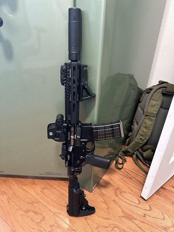

10.5” pistol hear with a YHM Ti Pantom. Firing 220 gr subs - all you really hear is the action of the firearm.
I’m building an 8.2” when all my Black Friday parts arrive. YHM Resonator 2 in Jail. I’m excited about this one
